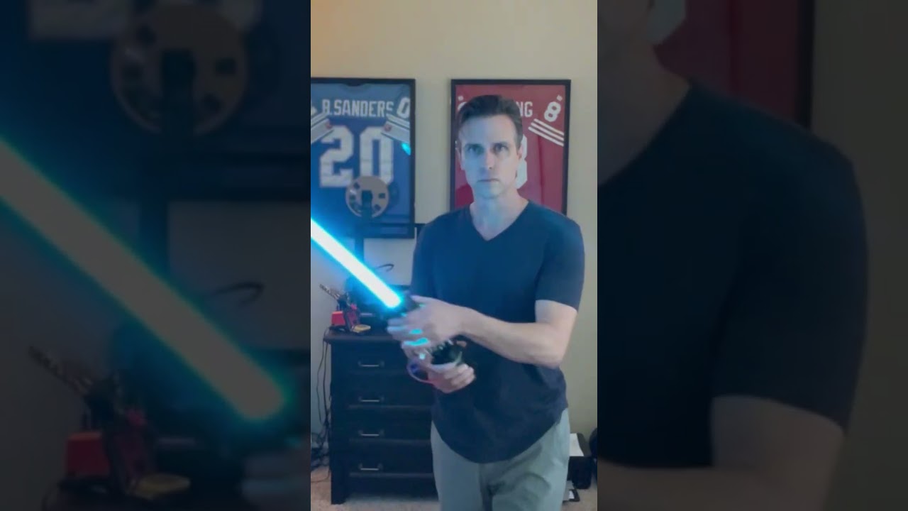

Just wanted to thank everyone who helped me out with all my crazy questions. Here is the nearly completed project i’ve been working on.

ok, thanks for the info. I’ll just alter the two font wav files and make them fit my ignition and retraction durations. I got a custom setup with with a fully extendable / retractable blade, so i’m not using any blade effects. Check the video i posted earlier in this chat.
