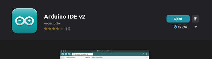

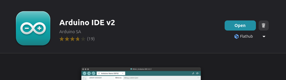

It shouldn’t. I didn’t use the Ubuntu app manager, and downloaded the gnome software myself (to avoid snaps as well). This is what my app list shows, flatpak.
I will try the app image to eliminate that variable.
Looks like it used flathub.
Flathub has a weird way to install things, but I haven’t had any problems with it so far. However, it is possible that flathub is the problem. I know it works with the appimage (because that’s what I use) but I have not tried installing Arduino from flathub.
