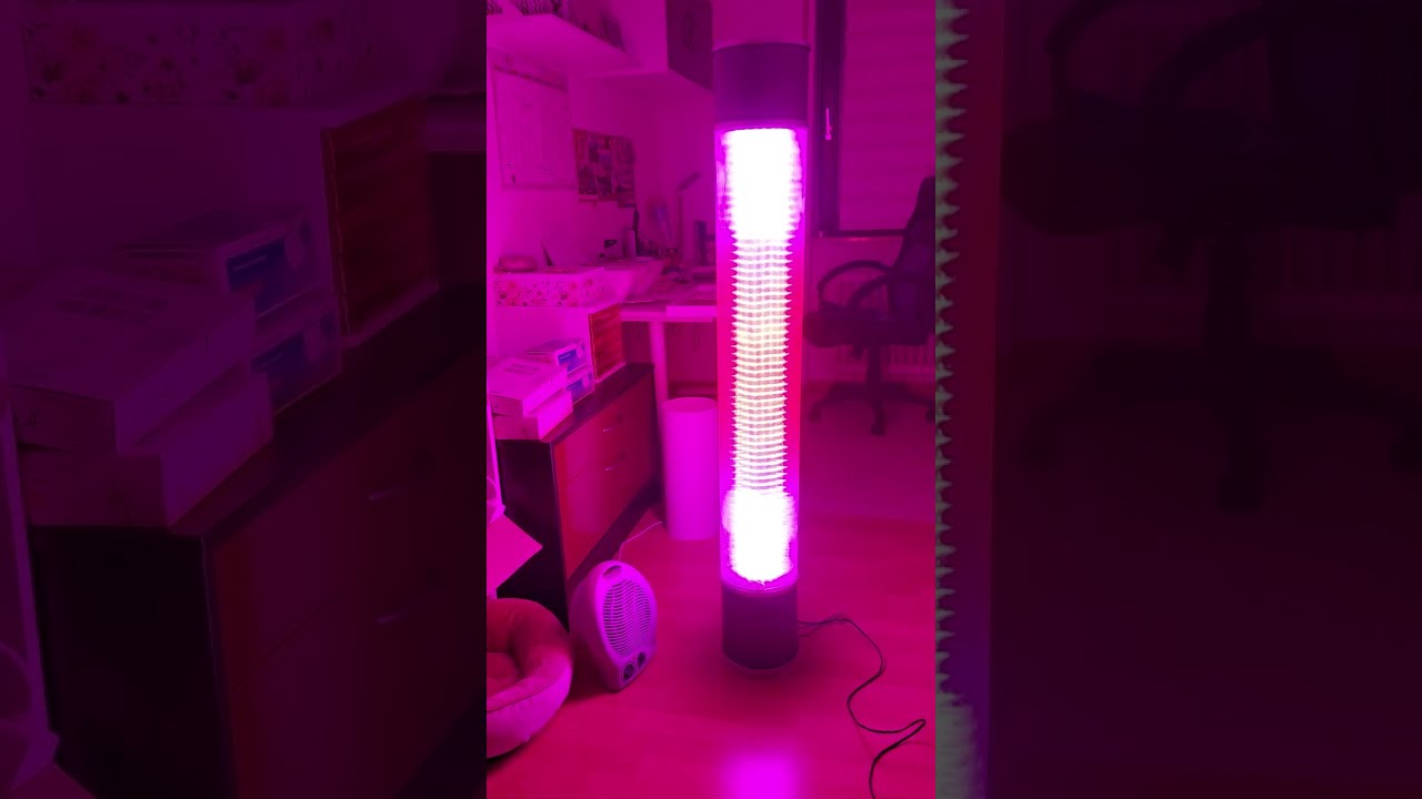

here is anther
oh ya its open source like proffie and uses esp32 and esp8266
