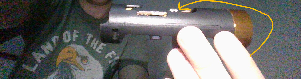

How to plug into micro usb port for arduino?
That silver thing (the side of it the arrow is pointing to) is the microusb port. As you can see there isn’t enough to plug the cord in because of the plastic shell of the core. Any ideas? All i can think is to take the shell apart but that’s a pain if I want to do it every time I want to add a preset. Also, if you have a specific micro usb cord that transfers data, link it pls :folded_hands: . I have a crap ton of usb c data cables for keyboards but no microusb lol
Its hard to make out in the picture, but if it doesn’t fit because of the plastic jacket surrounding the micro usb b end, I bet the maker assume you already have a low profile cable that most people have for proffies.
I have this one
This is also a good option
k thx. However, i might have to take it apart anyway because the sd card is literally between the plastic that touches the battery and the proffie board (it’s right below the microusb port). I can take it out of the slot but not out of the core because the same plastic that blocks the port blocks the card from coming out lol
