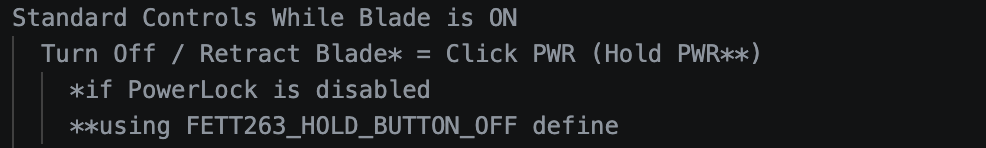

This right? do I have it defined to hold to power off then? sorry im lost lol (pic is from prop config file)
Did you add the define, if so, you’d just remove it.
no i just put fett263 in the prop config define. Ill keep looking into it maybe im overlooking my config file or something.
Are you sure it uploaded successfully? And/or you’re uploading the edited config?
