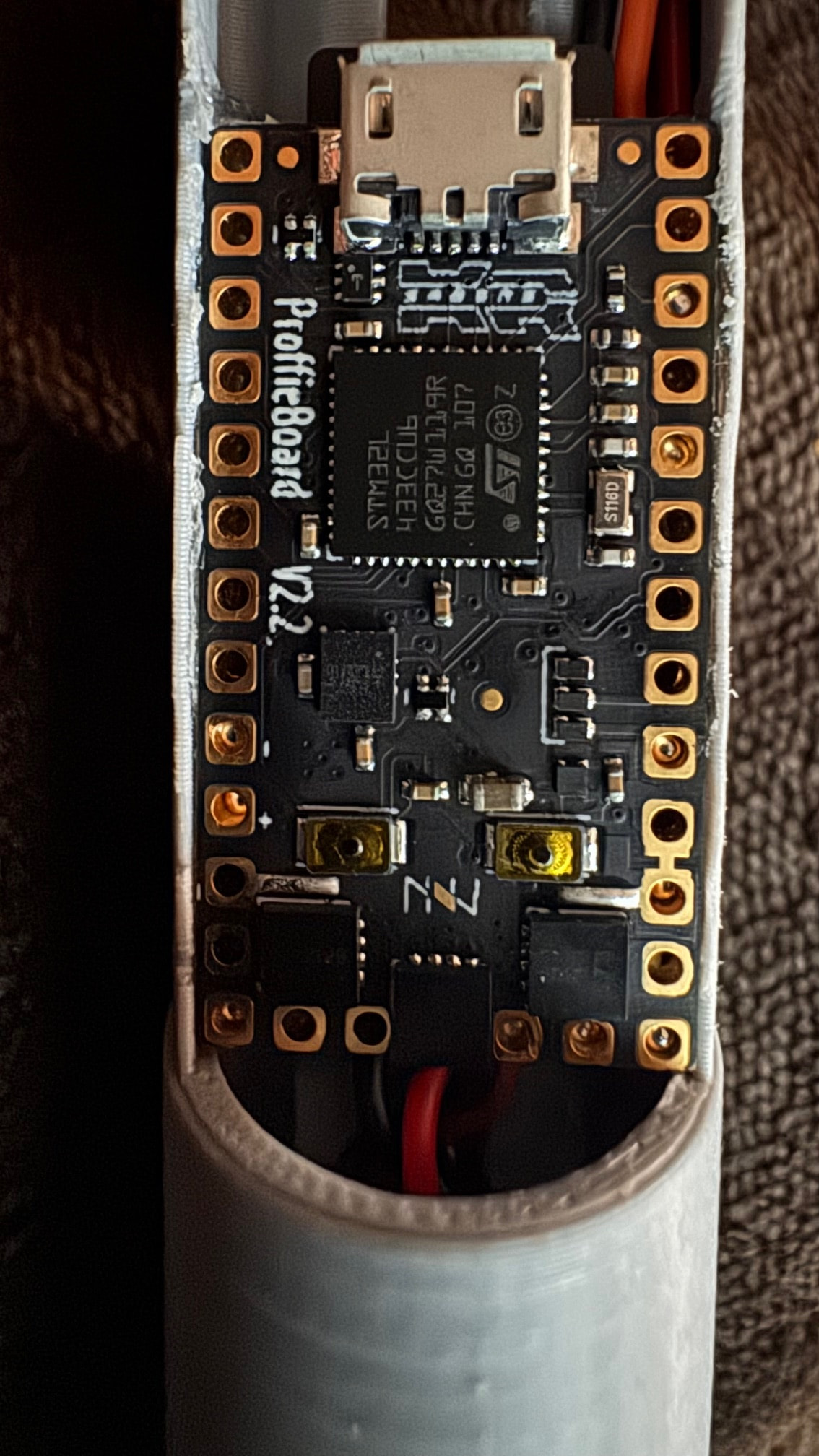

Thanks for the quick reply - I have attached a photo, you can see the full board from the underside
Perfect. As I suspected its an easy install.
You have one pixel line using data1 and led2/led3 bridged (very common), Batt+ and Batt-, 2 buttons with gnd connected, and a speaker.
Head over to the v2 configurator: Proffieboard V2 and the default config at the bottom will work for you.
Only thing missing from your sd card is fonts. You can download free ones, and there are some cool ones, but if you want an true sounding dark saber font, it’ll likely cost you about $10us.

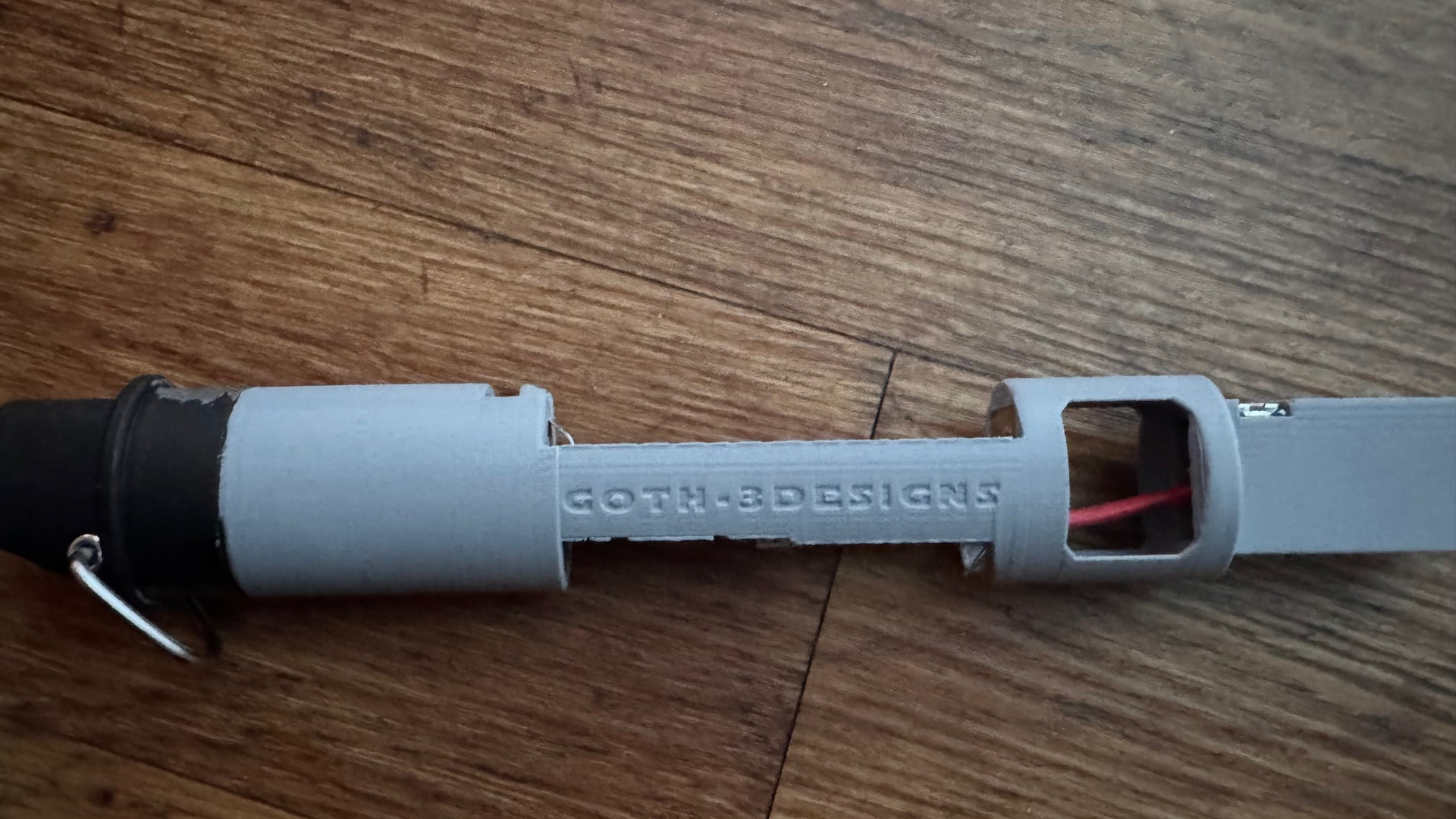

Goth makes a chassis like that for the Korbanth dark saber. You could try contacting them for a config file and font files, but I do not know how likely they are to help if you didn’t actually buy it from them.
