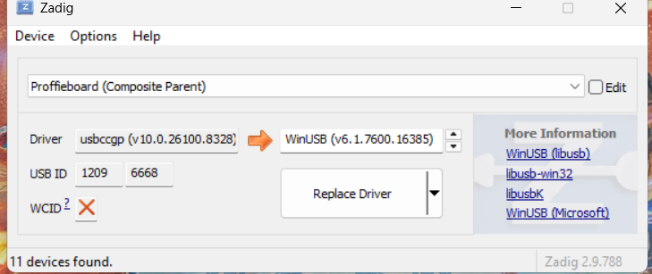

yes. It isn’t showing up in the list I have uninstalled and reinstalled but still no driver in the list.
should I replace the driver with this or no? the usb id didn’t match what this link says.
@profezzorn is there a reason the dfu setup wouldn’t work?
Yes, see if that works.
Just to clarify even though the usb id doesn’t match according to the site I should still try it correct?
If you’re using Zadig, follow the steps you linked here:
You want to change to the driver it says to.
The STM32 BOOTLOADER doesn’t appear in the list of devices. Unless it is the proffieboard.
