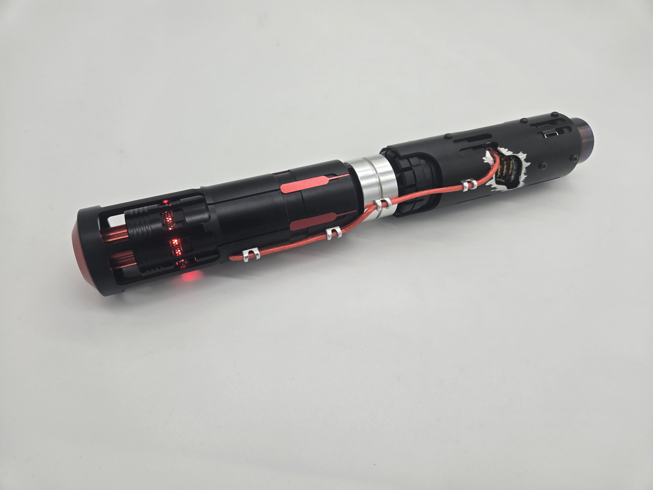

This is my Lukyanov Heart of Siberia.

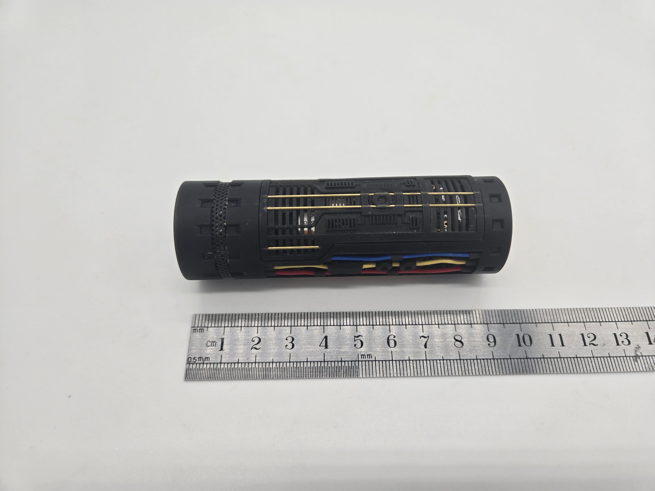

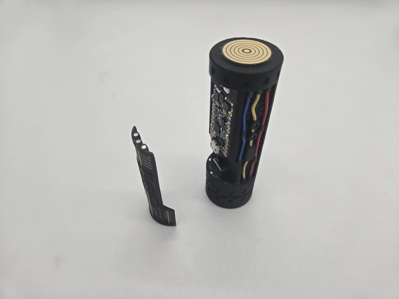

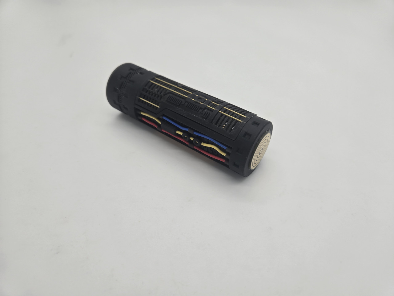

I designed the chassis in 24, printed it in abs like resin in jan 25, and just now finished the install! I had a bit of creator’s block I think.

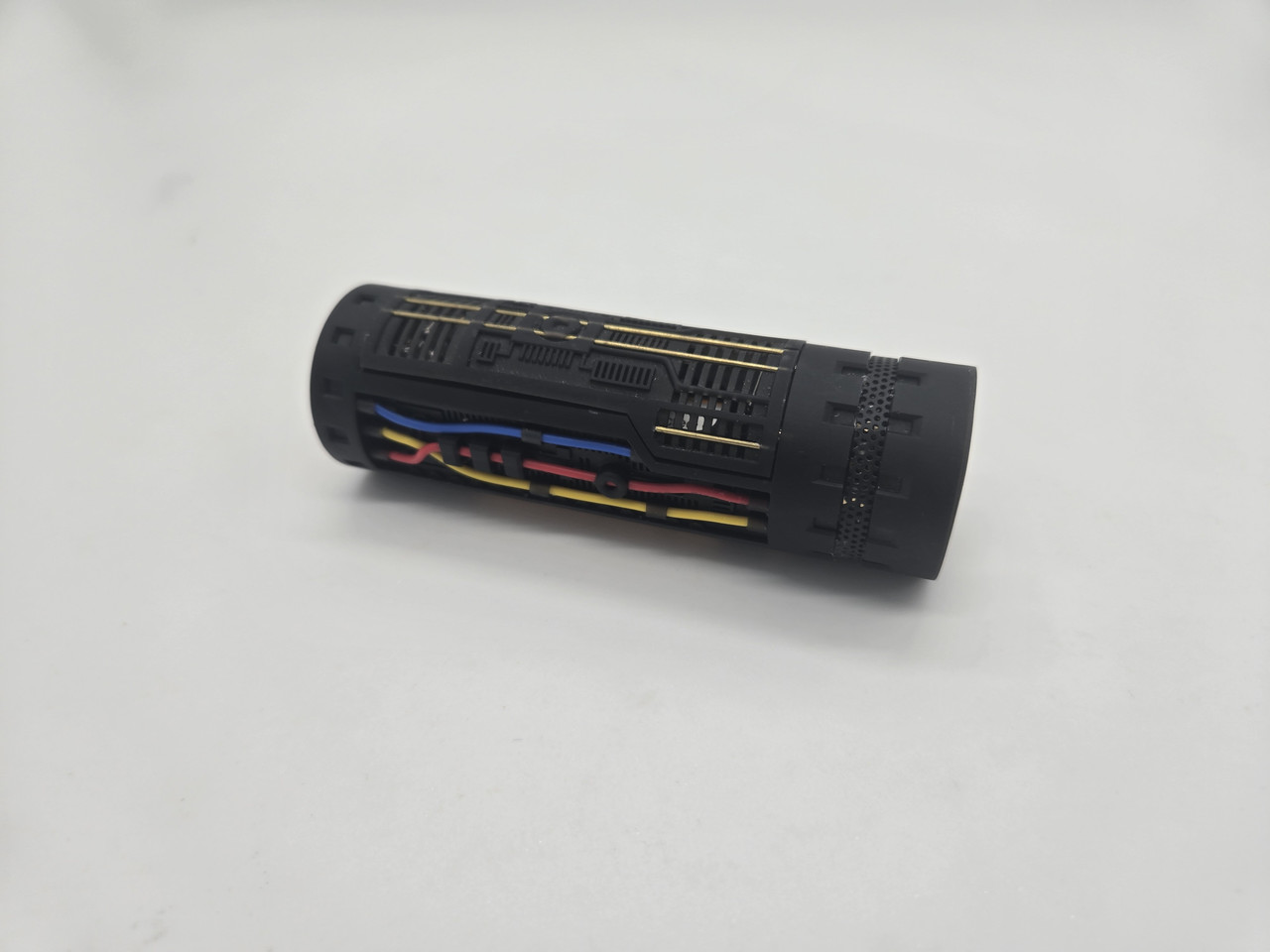

Its only 9cm long and 30mm in diameter! I designed passages for real color wiring.

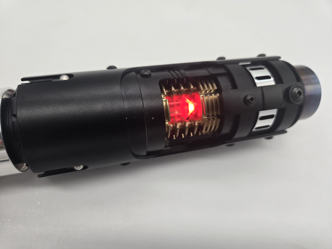

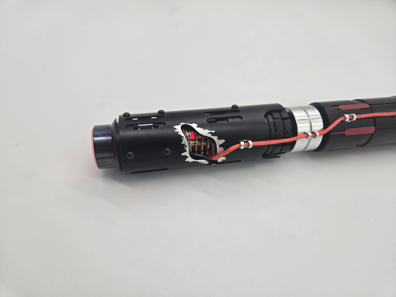

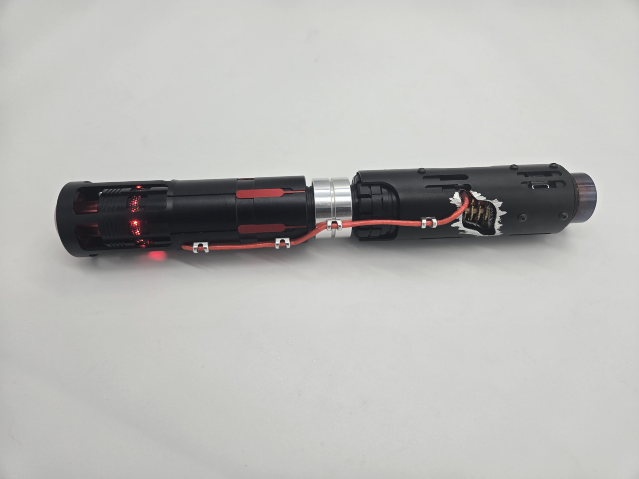

Here is the saber. You can see a mini pixel strip thru the pommel cuts.

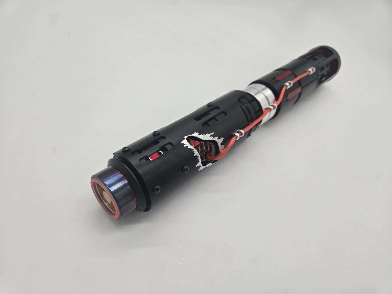

Only slight weathering. I roughed up the opening a bit more and files the brass. Also heat stained the emitter ring. It was so small it went to purple black almost immediately after starting to change colors.
It was fun and long project. Finally able to say I am done!

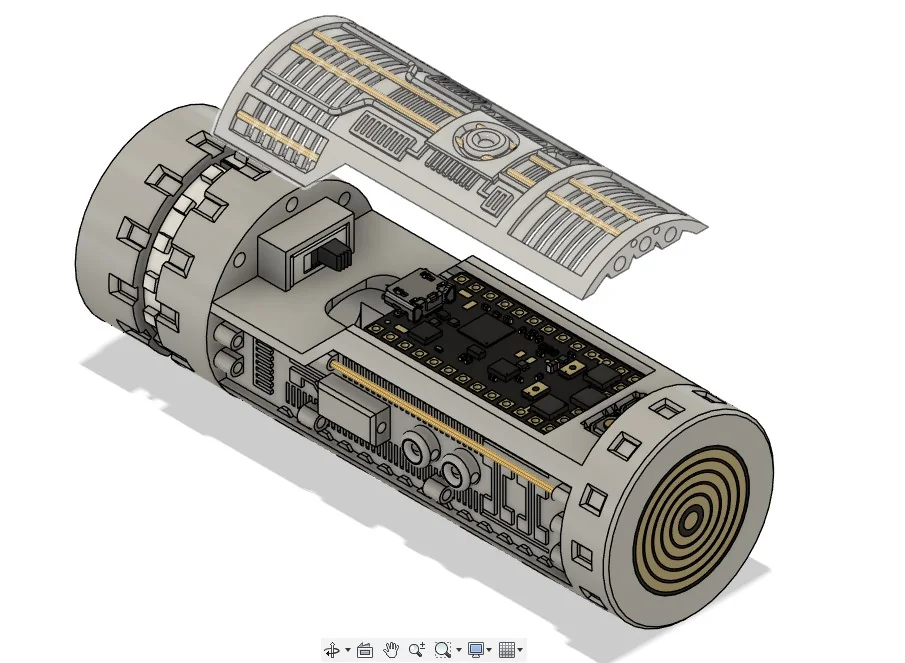

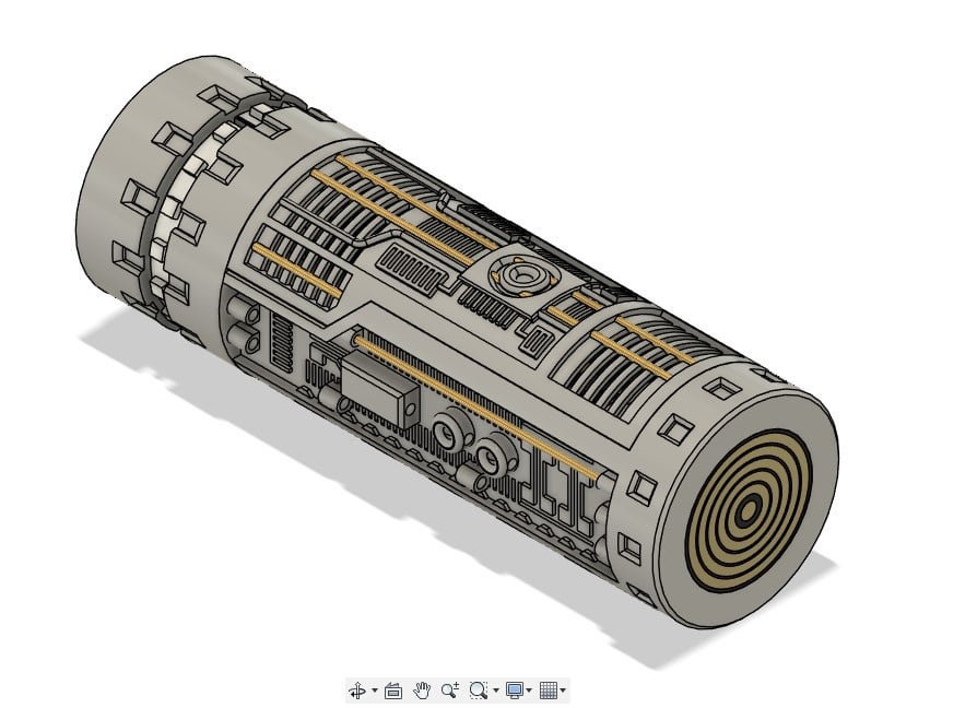

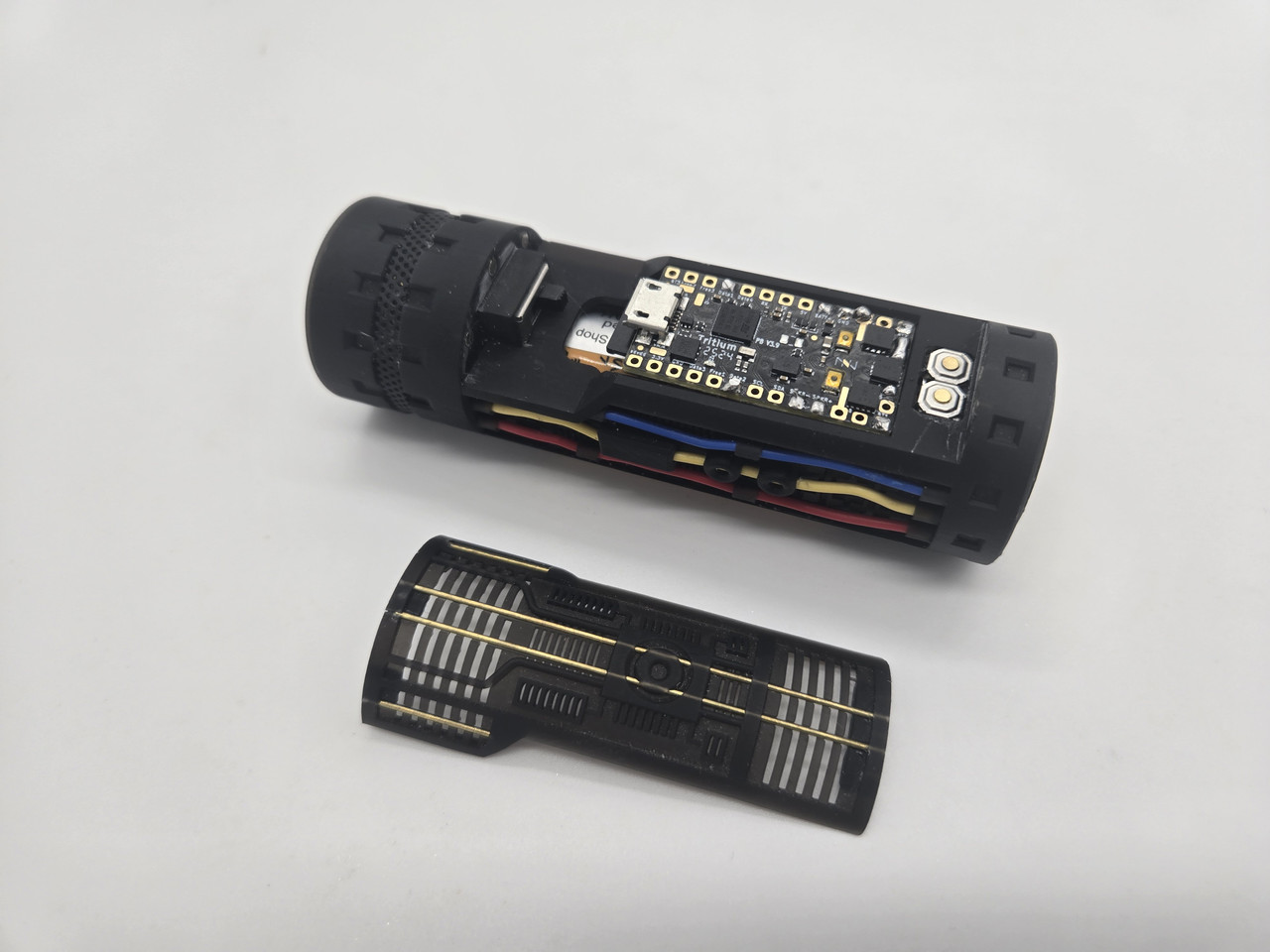

Here is the chassis design. It has a removable plate with brass rods. It supports a 28mm elite speaker, kill switch, 2 brass switches, 18650, and a mini pixel strip in the pommel area.
