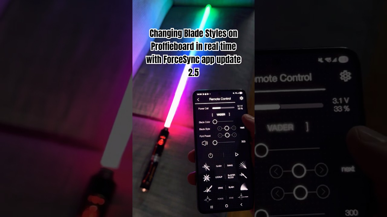

ForceSync Lite app has been recently updated to latest version 2.5 and now supports real time Blade Styles changing via bluetooth:
