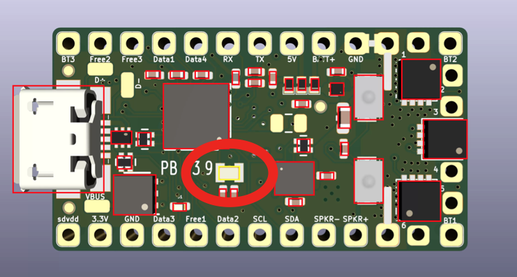

Just double checking this is the clock component I should try cleaning before I abandon this board to its fate:

Yep, that one, and the two capacitor right next to it.
