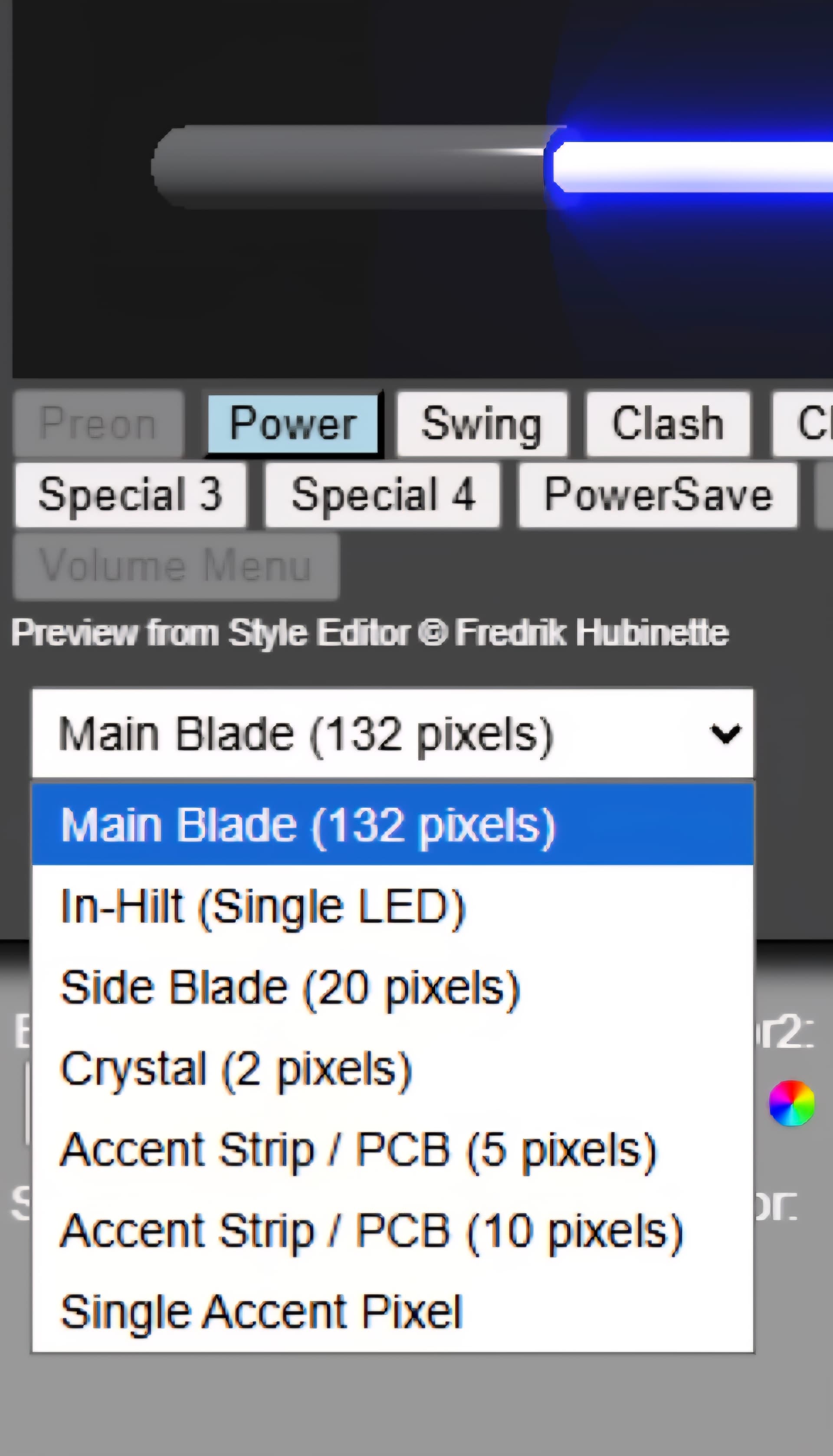

Hey everyone im a bit of a noob when it comes to proffie lightsabers i am wondering on fett263 when you go to blade builder and go to the blade pixel length it only says 132 pixles and my blade is a 144 pixle blade is there a way to change it to 144 pixles or does it do it automatically or something along the lines of that

Those settings are solely for how the Previewer shows the effects just as an example, they don’t have any impact on the style code generated or how the style code runs on your saber.
The BladeConfig section of your config is what controls your actual blade length on your saber.
