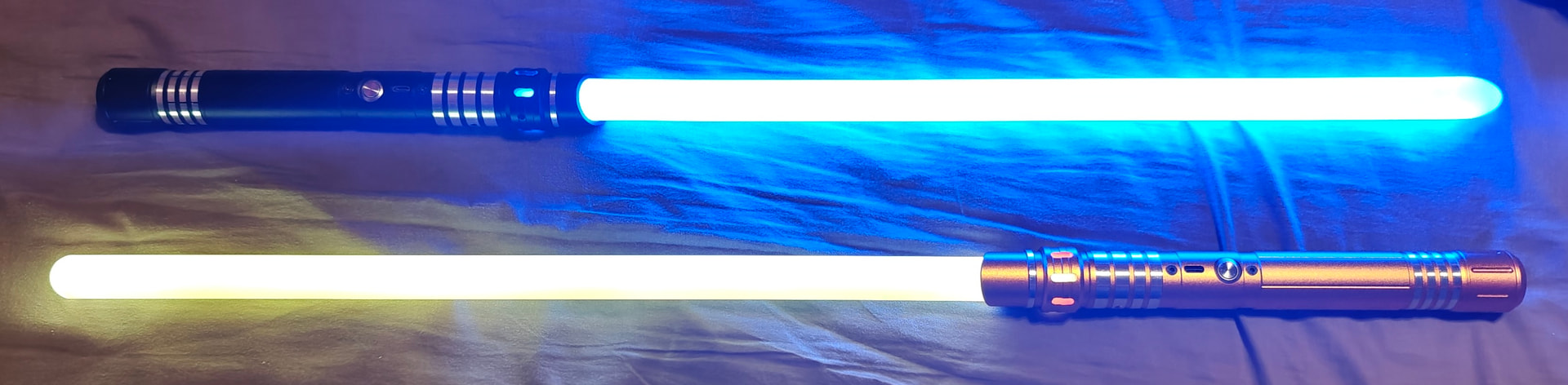

While waiting I found these IC+RGB Lightsabers on Amazon! I’ve seen this form factor in baselit several times, but these have real RGB strips in there, so for $36 for TWO I snapped them up!
They’re AWESOME. Like a mini lightsaber with real neopixel blade styles and decent sound from whatever speaker is in there. They flash on clash, have smooth ignition and some sweet preons. They even sorta respond to aggressive swings. The problem? No smooth swing, no customization, and mostly rudimentary blade styles. They just don’t have that proffie goodness.

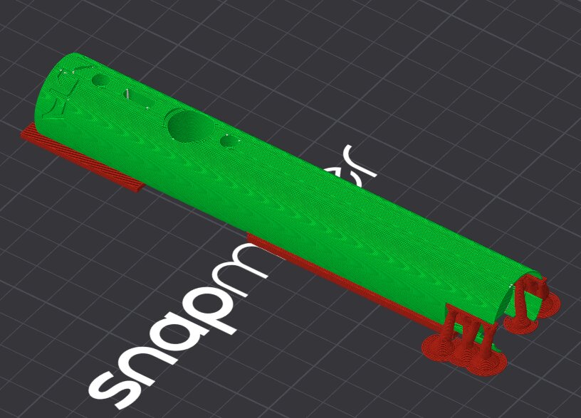

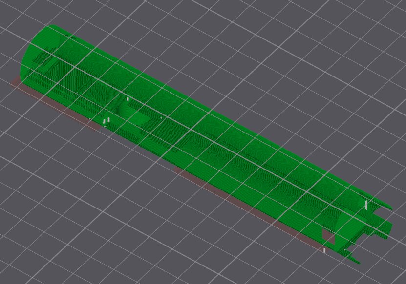

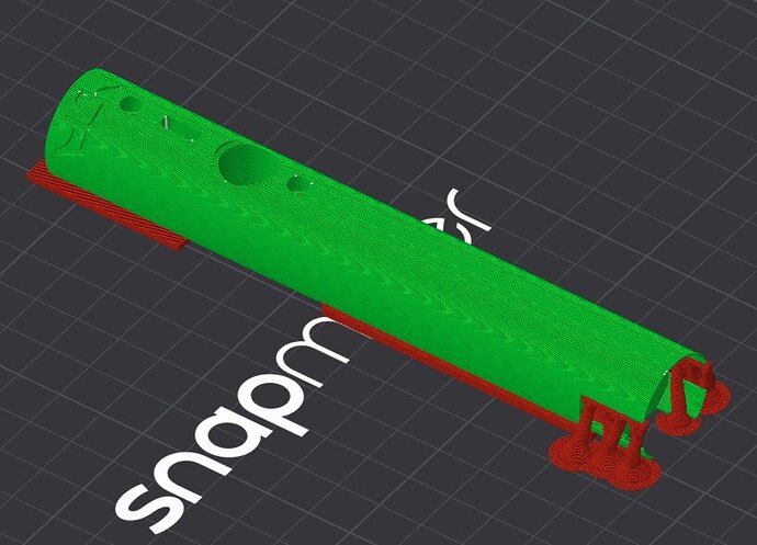

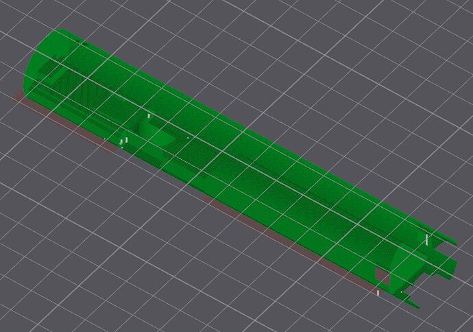

I ended up designing a custom core for them (it sucks and needs a lot more work but does technically hold everything together:

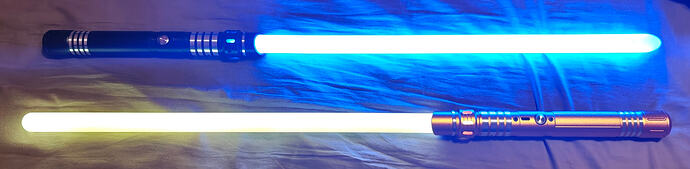

That yellow one looks great. A bit of weathering would really make it pop.

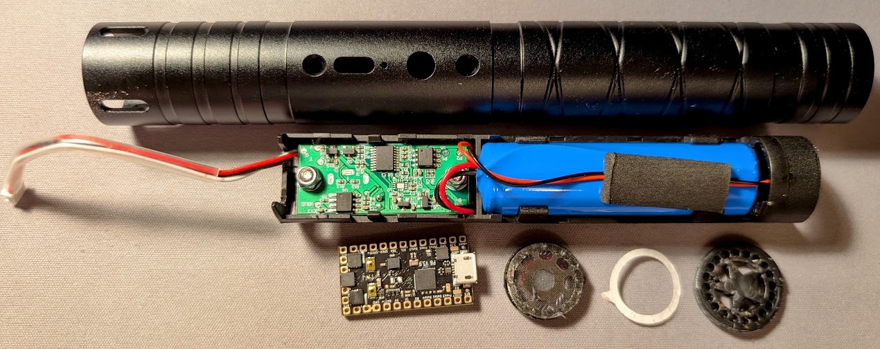

Amazon delivered the doomed pair earlier today…
Unfortunately (or perhaps fortunately), you have to go in through the but.
I added a proffie for scale. The Star plastic is the but, then there’s the plastic ring with tab, then this exotic little speaker that sounds halfway decent. We can do a whole lot with this! I wonder how many pixels are in the blade…
oh, there definitely looks like there’s room for a proffie in there. good find! amazon said they were gonna be delivered yesterday, but have since still not arrived…

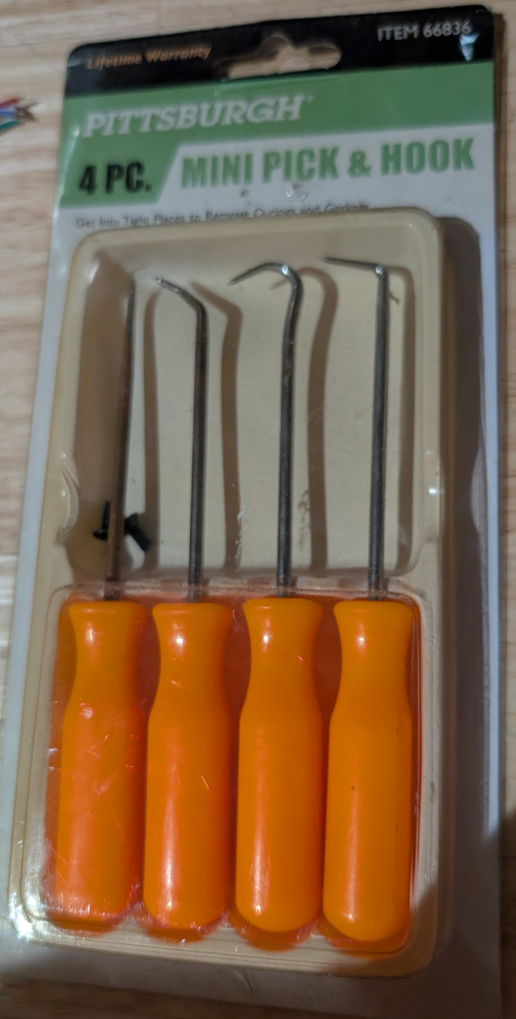

Gonna have to crack another joke. A set of caulk hooks is tremendously helpful in the but.

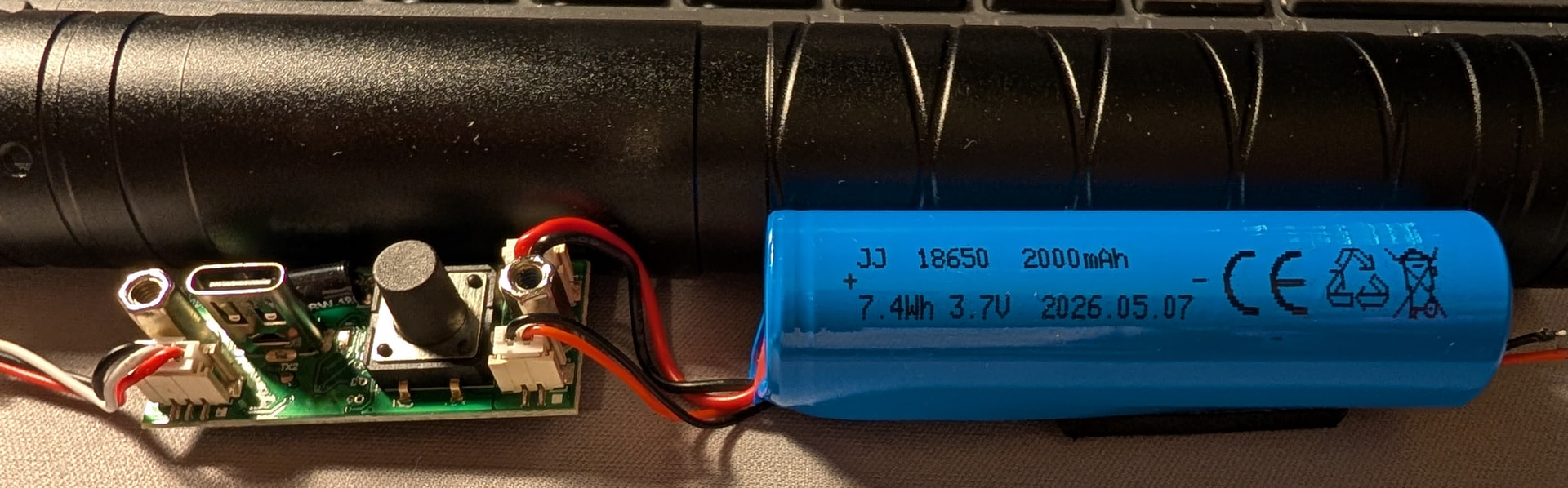

18650…
It’s 49 pixels and appears to be one-sided, but with good enough diffusion that it kind of wraps around. I was able to unscrew the plastic disc covering the speaker, partially unscrew the screws on top to push the switch assembly down in order to slide out the chassis, and it came right out without issue for me. This is a VERY small little saber and might be kind of humorous putting good electronics in it… We shall see :slight_smile:

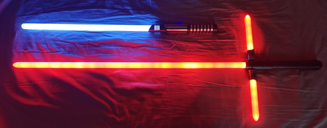

Oh, and there’s a coupler in the box. So… could end up being a small staff.

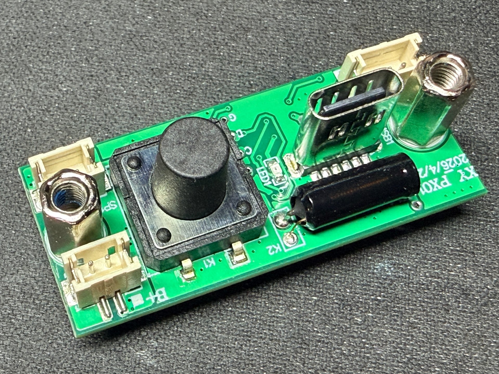

that integrated button is gonna make it a little harder to convert, though… all the other cheapo sabers I’ve worked on have had the same standard button

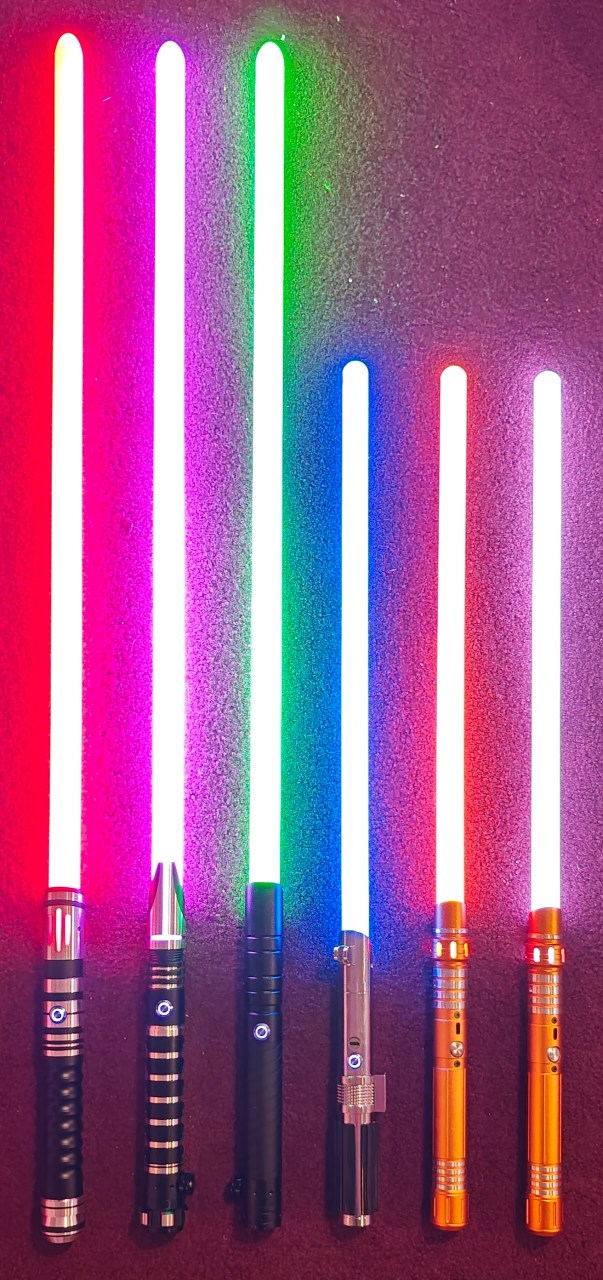

putting fancy electronics in tiny sabers is always hilarious, I’ve done it a couple of times now, once as a custom build for my baby cousin

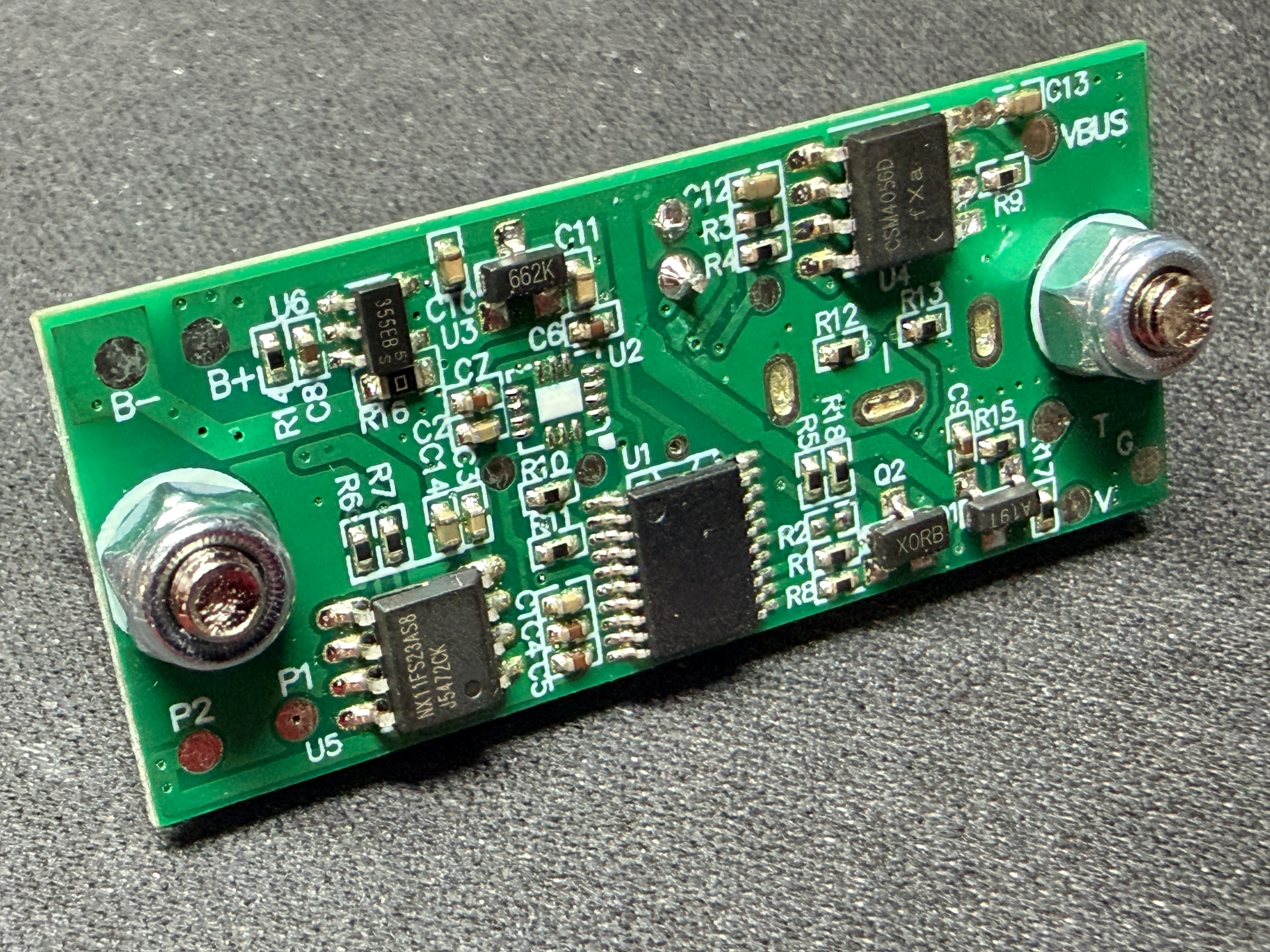

Yep, I’ve done the ones on the right there too. Though these are smaller than those. But still plenty of room in the provided chassis. As for the button and USB… I was considering using this board as a breakout by removing the ICs and other components that would interfere… but if I intend to be able to program without disassembly then that won’t work since this is a 6 pin USB C port. Might be able to rig up a 16 in it’s place, but then I may as well make a small Proffieboard sled to fit in to this slot (that’s the easy way and only salvage the standoffs and maybe the button.
I’m tempted to whip something up in KiCad that has the same dimensions and spacing that serves just as a breakout board for the proffieboard (keeps the button, usb port, standoffs, and JST connectors in the same place, but has pin headers on the other side that you can just slot the proffieboard onto and then solder on… The biggest issue there would be the shipping time though
That could be cool. I think something 3D printed makes it an easy way to both hold the Proffieboard and provide a mounting location for the other components. If I were doing a bunch of these a custom PCB would be worth doing for sure.
