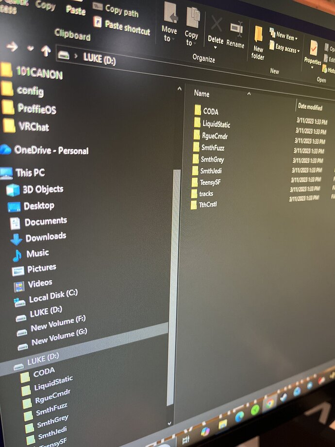

Every time I put my battery into the chassis it says “font directory to long”
What could this mean? My original SD card got corrupted and I got a new sd card with a few fonts on it. Does anyone have the default fonts that I can download? And what could be the issue here?

Okay thank you sorry. But any clue to why it is saying that? And yes I did download those fonts from that link

I got it thank you so much! Also another thing,do you have any of the other main factory fonts I can download because I found out that the reason it saying “font directory not found” is because the font isn’t there! So I need the rest of the factory fonts. If you or anyone has them I would be very appreciative!
