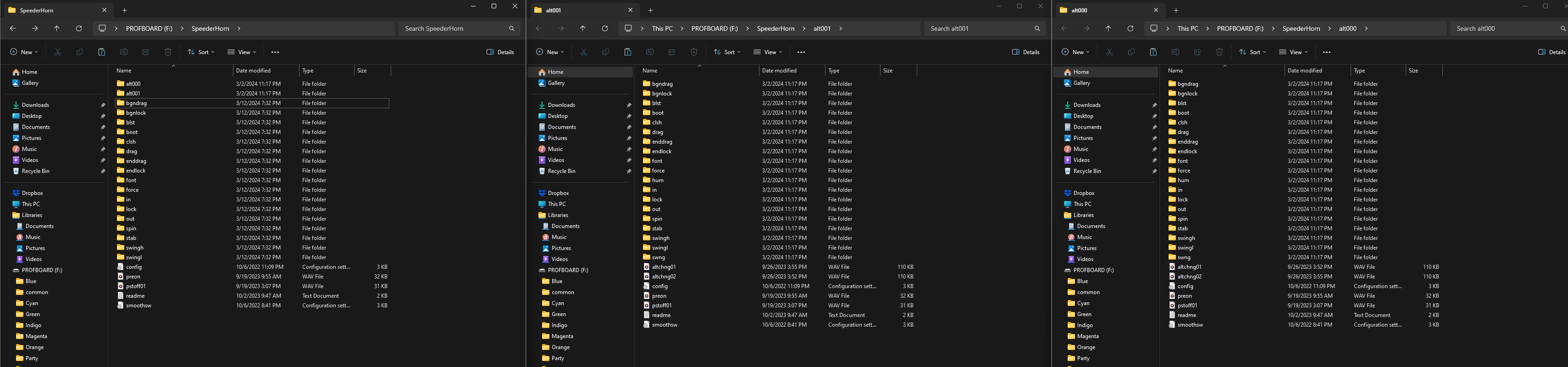

These are the folders in this particular font.
Anything else, please let me know and I will do my best.

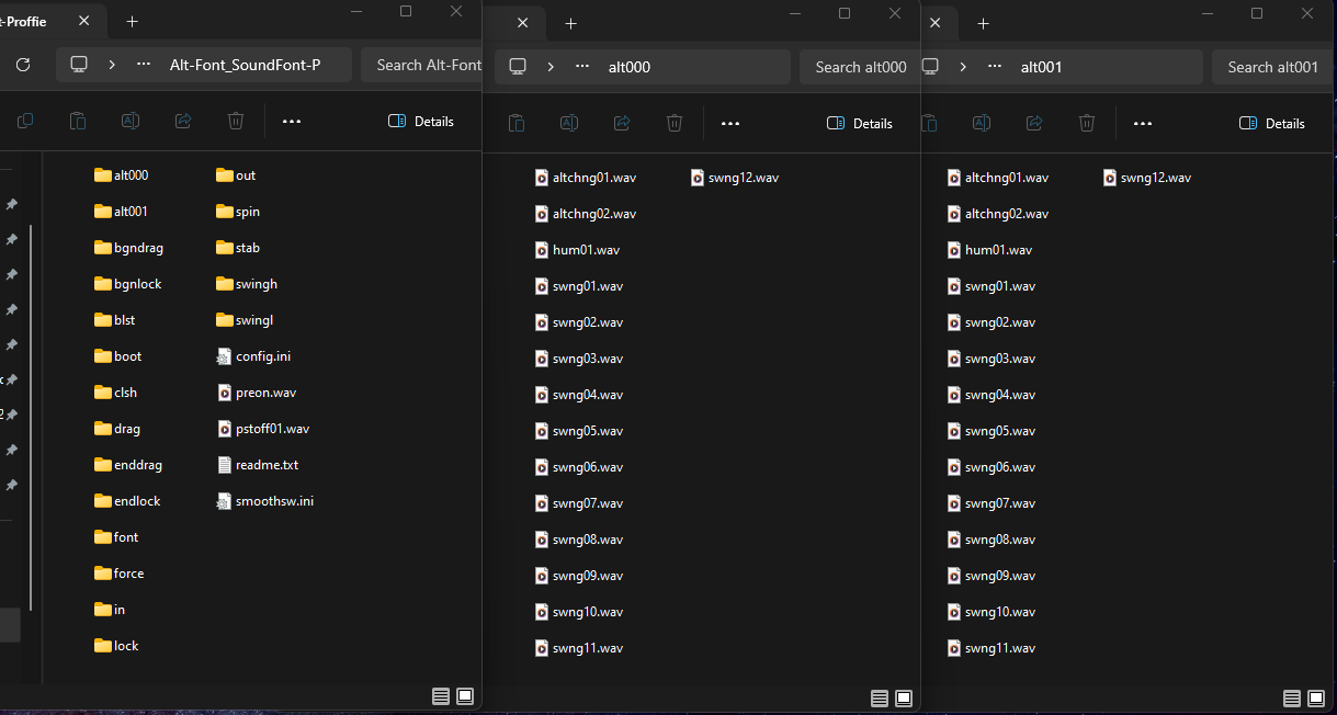

In the alt000 and alt001 folders, to my understanding the only files that need to be in there are the sounds that will be changing when you activate the change on your saber. In the case of this font, only the hum and accent swings change. Based on your screenshot, it looks to me like you are trying to copy the entire contents from the main font folder into the alt000 and alt001 directory, which isn’t necessary.
I have it on my saber as shown (image below) and it works just fine. The font package was already preconfigured with the folder structure/wav files already set up ready to go, all ya have to do it drop the main font folder in your SD card and add your blade style in your config.
Yes, i figured that much, but i dont know what its asking for, is what i am trying to say lol. Its not cut and dry to people who havent messed with this and its coding very often lol. But BK just replied so ill see what he mentions. :smiley:
Ok cool, thanks my friend, i thought i had it proper at first, but there is a chance i could have messed with the folders ans files prior to putting content into this new sabers sd card, i will give that a go and let you know. Thanks!!
Please beware that alt000 and alt001 has to have exactly the same filenames in them. If there are 5 swing sounds in alt000, the must also be five swing sounds in alt001, with exactly the same names. Only the content of the files is allowed to be different.
Yes, and they are, that was one thing I double checked on, peeled through all the folders and files and checked the sounds and names, and they were named properly, but different sounds for some. Like BK said, I didnt realize there were only supposed to be the differences in there, and those folders would then share the main font folder for everything else. Thanks Zorn!
I mean, you nothing is really stopping you from having identical files in alt000 and alt001. However, now that I look at your directories, I do see a problem. Looking at “bgndrag” you have it both in alt000/alt001 AND in the font directory, that will probably not work. For each effect name, it needs to be either in alt000/alt001 OR in the font directory, not both.
Just checked your original zip file for the font, and yep, i sure must have moved all files to those alts for some reason lol. I’m going to move the original back and see how it goes
This was exactly the problem lol. Thanks @BK_Saber , @Fett263 , @profezzorn for chiming in and lending a hand, much appreciated!! I did however learn quite a bit from this little fiasco, so something came from it lol.
