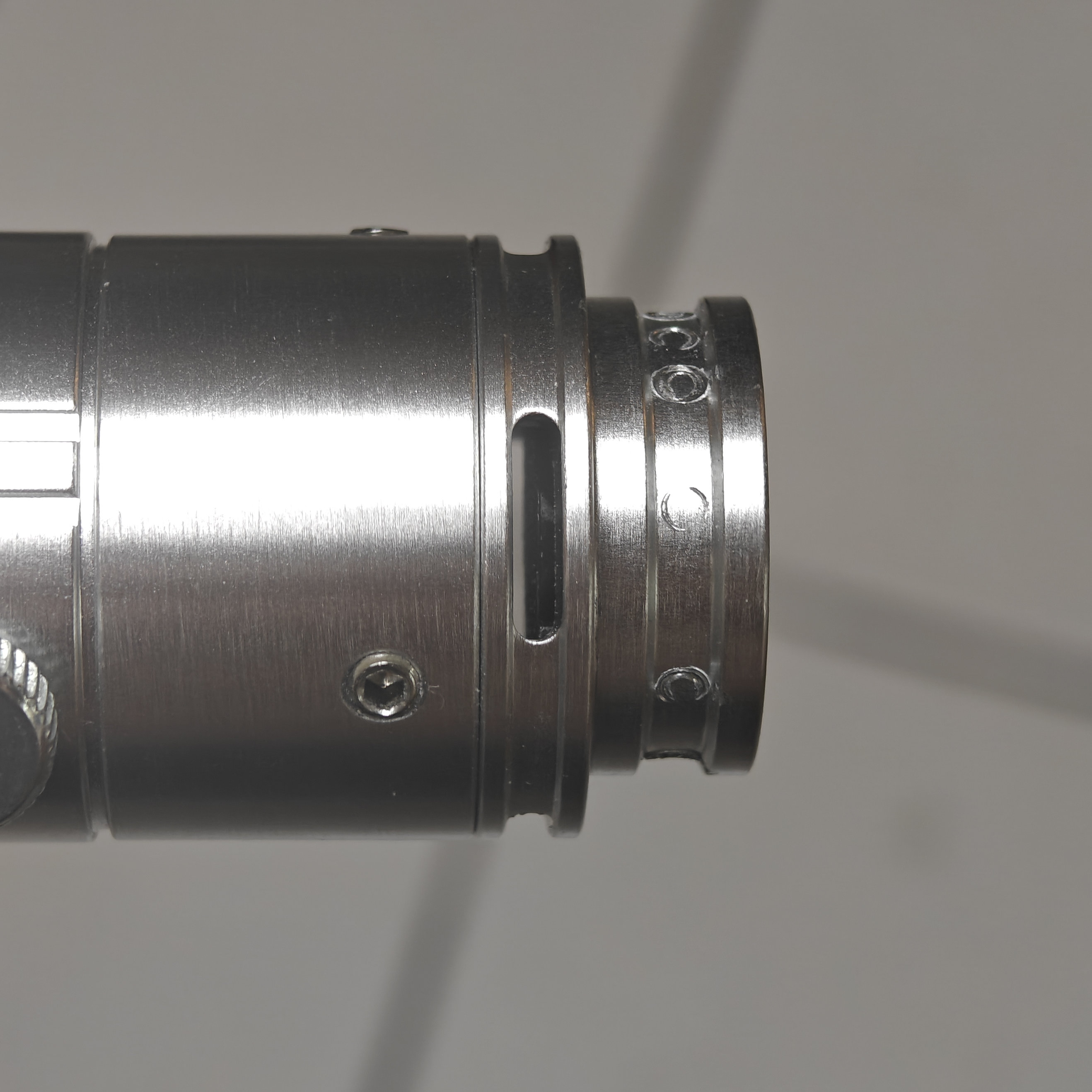

I have a Darth Maul saber that’s 2 sabers connected at their pommels, with the speakers facing directly toward each other, creating a comb filter effect when they play the same audio at the same time. I’ve tried reversing the polarity of one of the speakers but I believe there’s just slightly too much offset for that to make a difference. Is there a way in the OS to slightly offset sounds to prevent them from colliding (iirc about 40 or so milliseconds of delay/offset would prevent this from happening), or do I just have to edit starting points for all of the soundfonts on one of the sabers?

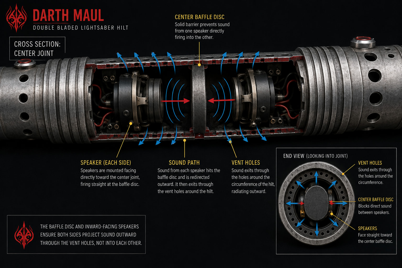

Depending on the venting, you could try a skinny baffle at the joint, like a thin disc piece of something. This would have the sound from each speaker exiting at 90 degrees spherically (side by side) out of the hilt before the sounds collide head-on.
It might help?
Actually, slightly angling the whole disc would let more waves bounce outward instead of reflecting directly back home, and then you’d sort of have more sound of each speaker coming out of either half-sperical side of the hilt. … if you can picture that.

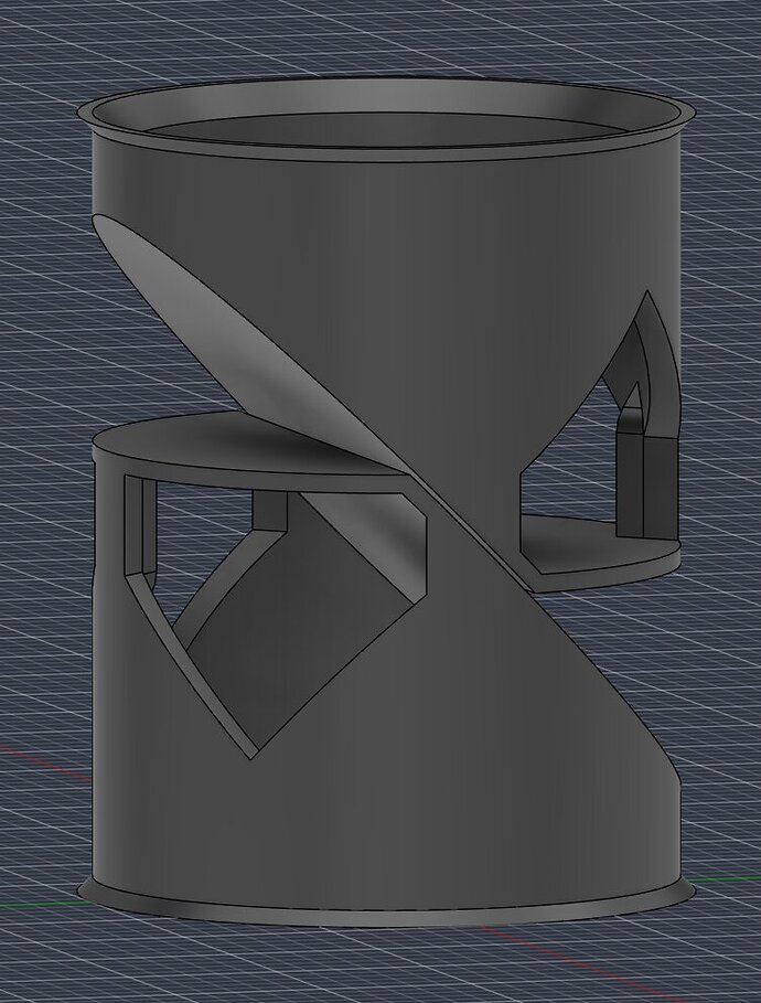

Funnily enough I tried something like that before posting! Unfortunately I think the holes are just way too small for it. I whipped up a small part that slid into the joint and deflected the sound outward, but it didn’t do too much.
Your angled disk idea intrigues me though, I might try that…

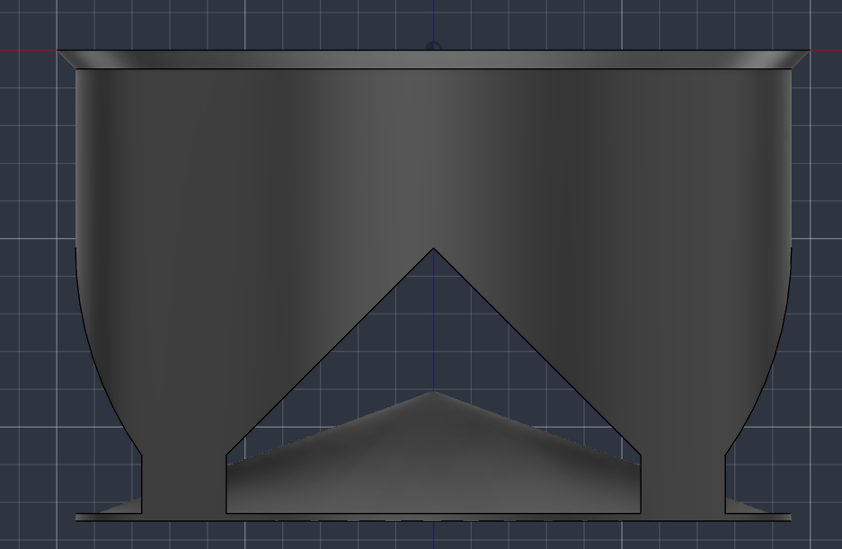

The joint has 4 holes, so if I could funnel each speaker out of 2 opposite holes they might not collide nearly as much

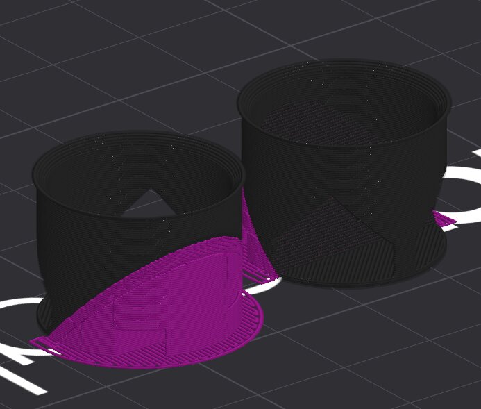

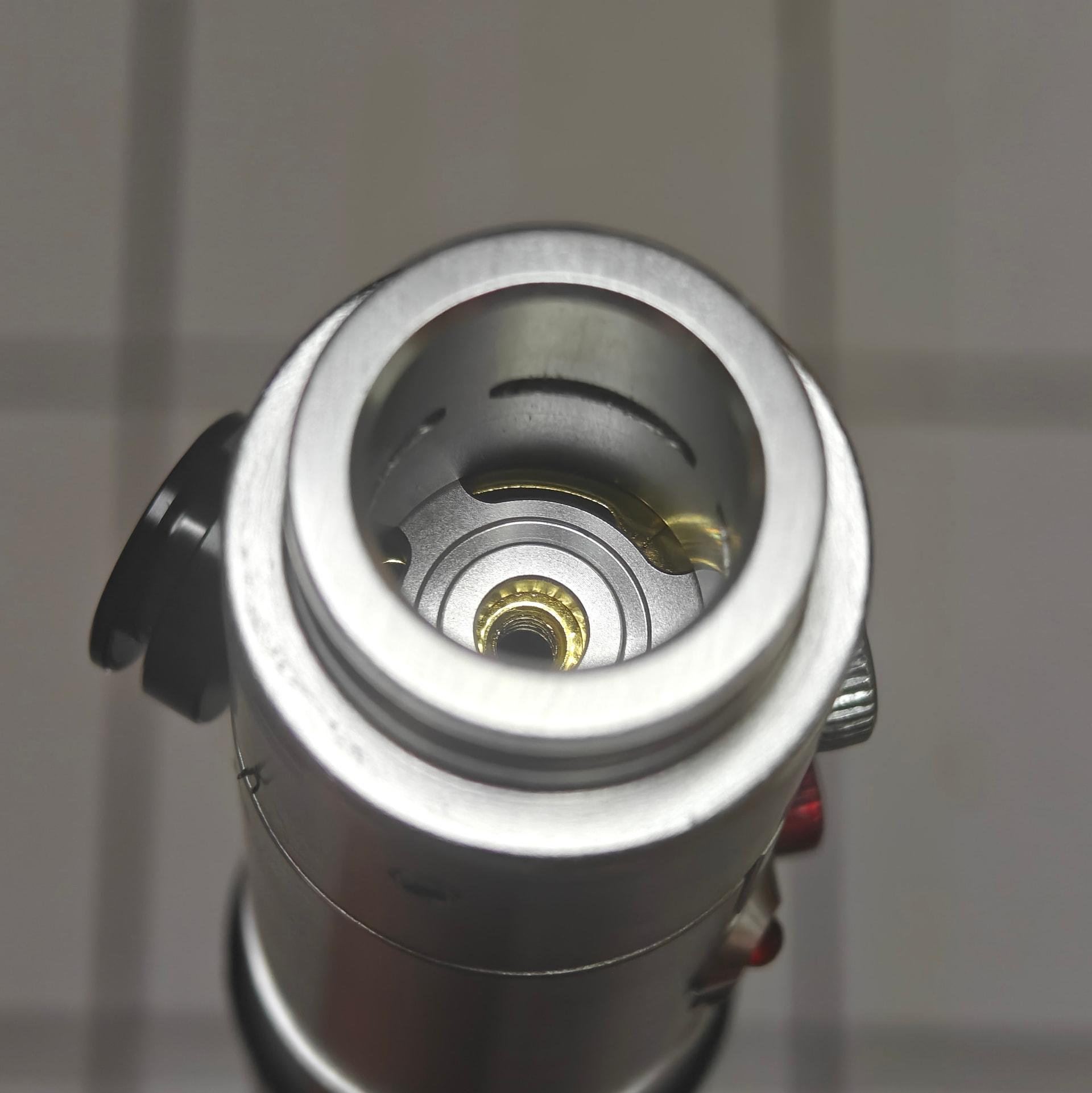

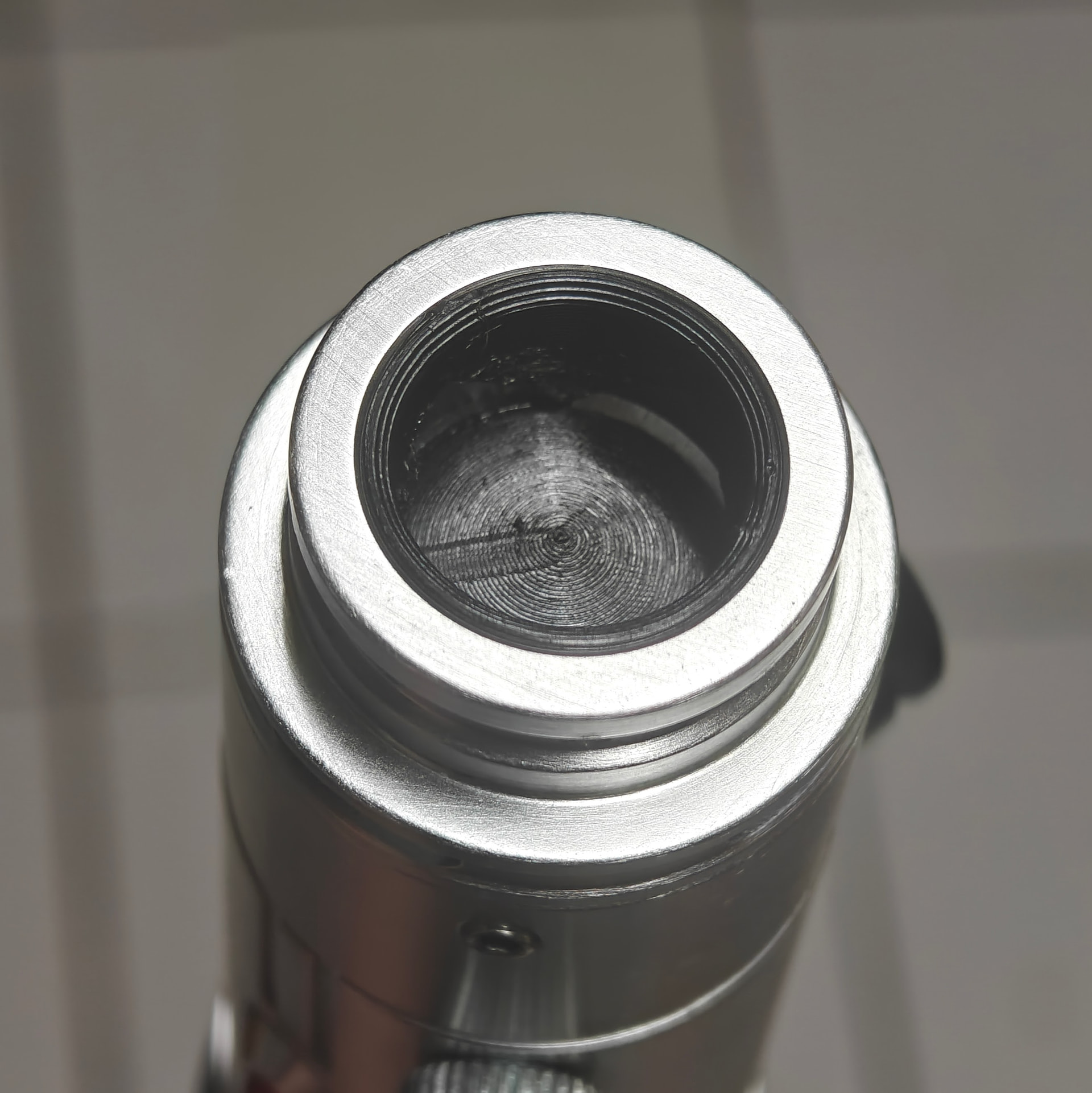

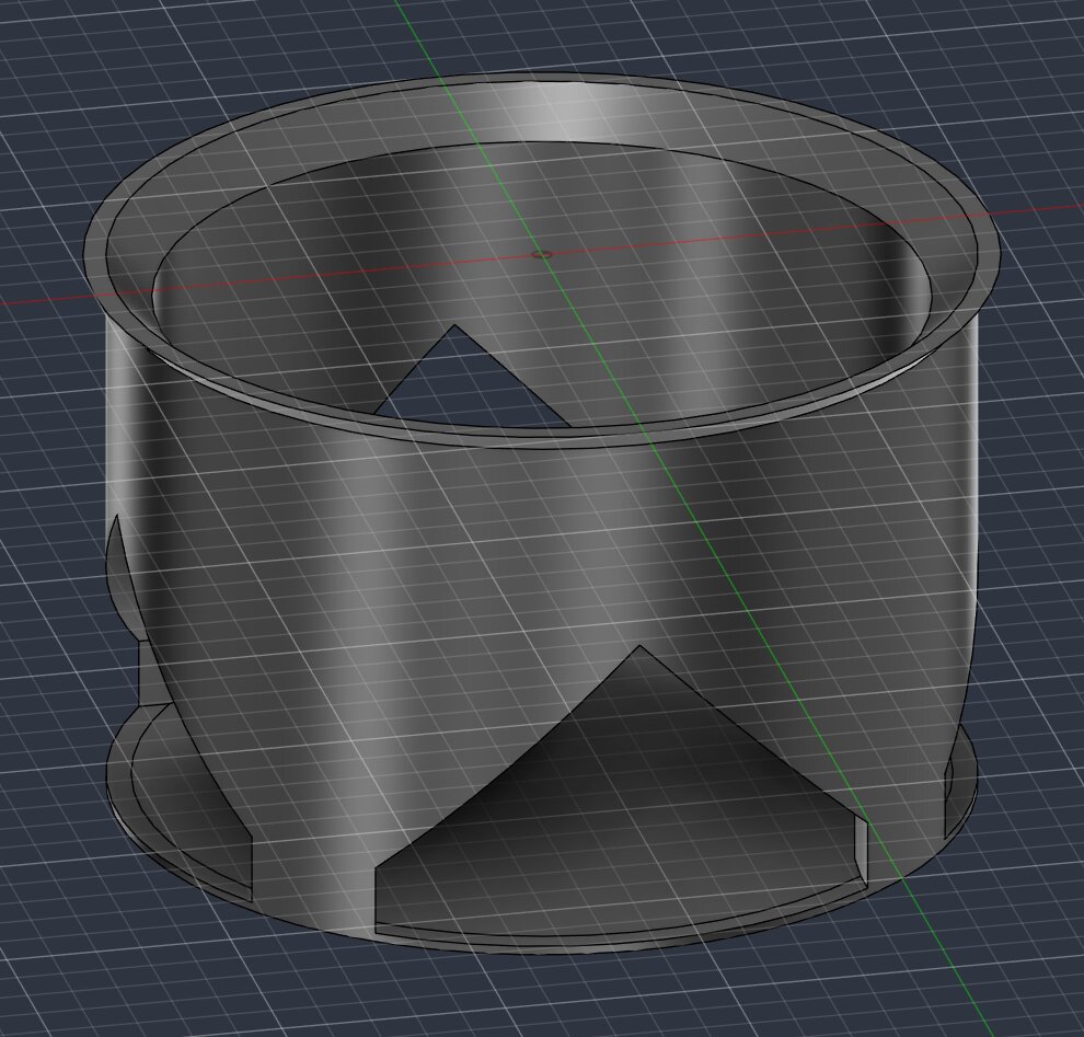

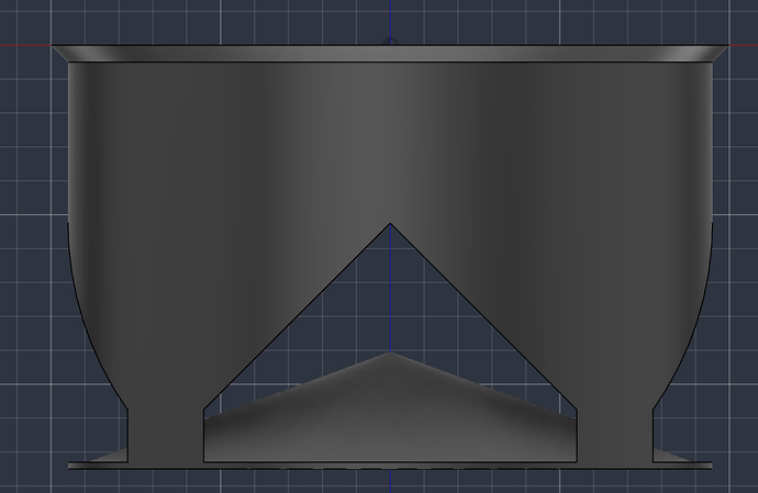

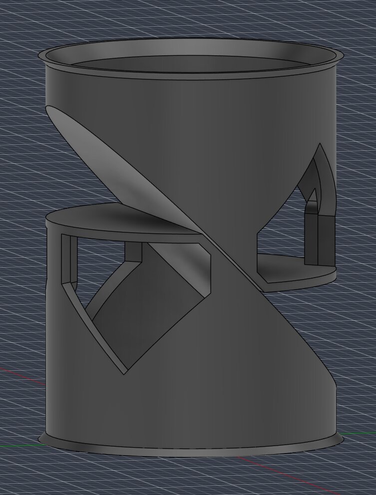

I designed a little doodad that funnels each speaker out opposite sides of the joint piece there, and while the flanger effect hasn’t gone away completely, I think it’s definitely been reduced.
darth_maul_dual_speaker_fix_v2.stl (153.7 KB)
I’ve attached the STL to this post, so if anyone else has a Nexus/DamienSaber Maul v2 they can use it as well.
Interestingly, if I cover two of the holes (blocking one speaker completely) the effect goes away entirely, so it’s definitely something to do with how it’s interacting outside the saber.
…maybe I’ll just design a piece that blocks one speaker entirely…
