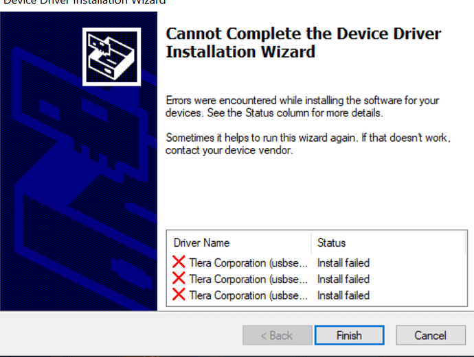

I already did zidig so idk what went wrong so I just went and tried to use proffie-dfu-setup and it gave me this message when trying to install it
That doesn’t look good.
