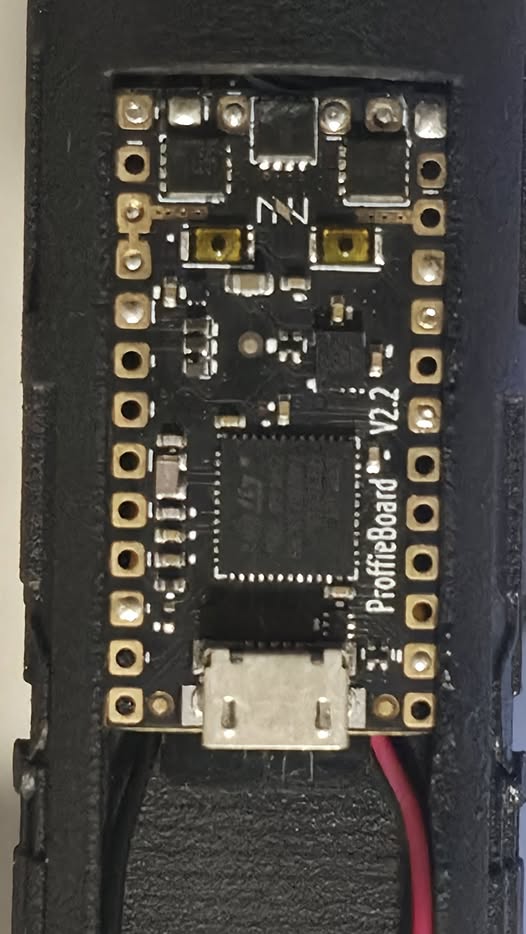

Hello all hope your well. I’m having trouble trying to edit the crystal chamber on my new saber. Unfortunately, the SD card did not come with the flashed config, but I was able to track down someone who had it. Sadly, when I flashed it after making my edits the crystal chamber comes up only white. I have no idea if it is the style or the pins. I’ve attached the config to the post and a picture of the board. Thank you for the help!
