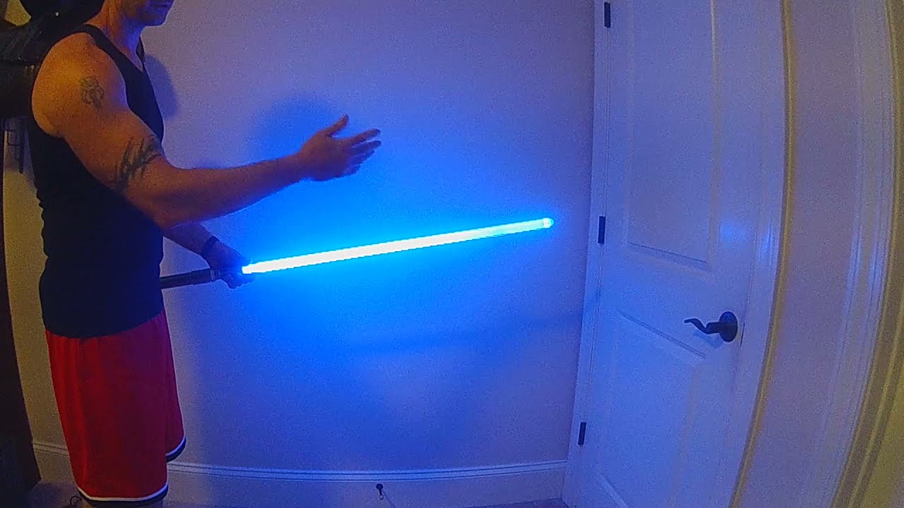

Countdown to ProffieOS6 - “Water Blade” Showing Off New Functions, Transitions & Style Modifiers
ProffieOS6 is going to introduce so many new style capabilities with all of the new functions, transitions and style modifier capabilities that I wanted to give a glimpse into the level of detail we’ll be able to put into styles.
This is a new “Water Blade” style that I put together to showcase some of what is now possible. The “water” on this blade will flow based on gravity and slope, when your blade is pointing straight up it will flow towards the hilt very fast but as you move the blade towards parallel it will slow and level off. Then if you point down the water will start to “pour” out of the hilt towards the ground picking up speed the further you tip it.
In addition, the ignition and retraction effects not only react to the angle of the blade with straight up or down being the fastest and parallel being the slowest but the direction of the transition will also follow gravity. If you’re pointing up the blade ignites from the tip to the hilt and retracts in the same direction but if you’re tipping down it will pour out from the hilt to the tip.
But to take it to another level the “water” flow also reacts to inertia, if you swing hard enough you can reverse the flow of water up the blade to fight gravity for a little while until gravity ultimately takes back over. The speed and amount of the flow up the blade fighting gravity will be based on how fast you swing the blade up, so really fast swings upward will let you reverse the flow for a longer period than slower swings. This also applies to the ignition effect, if you use Swing On and swing fast enough you can reverse the flow of water up the blade and have the ignition come from the hilt when pointing up.
Finally, I’ve added a new clash ripple effect that reacts to how hard the blade is clashed, with light hits producing a small quick ripple in the water and harder hits producing much larger ripples overs a bigger area for a longer time, the intensity of the ripples dissipate over time just like the surface of water adding another layer realism to the effect.
And this is only the “tip of the iceberg” of what’s possible. ProffieOS6 will take saber effects to a whole new level and make things possible nobody had considered before, just wait…
