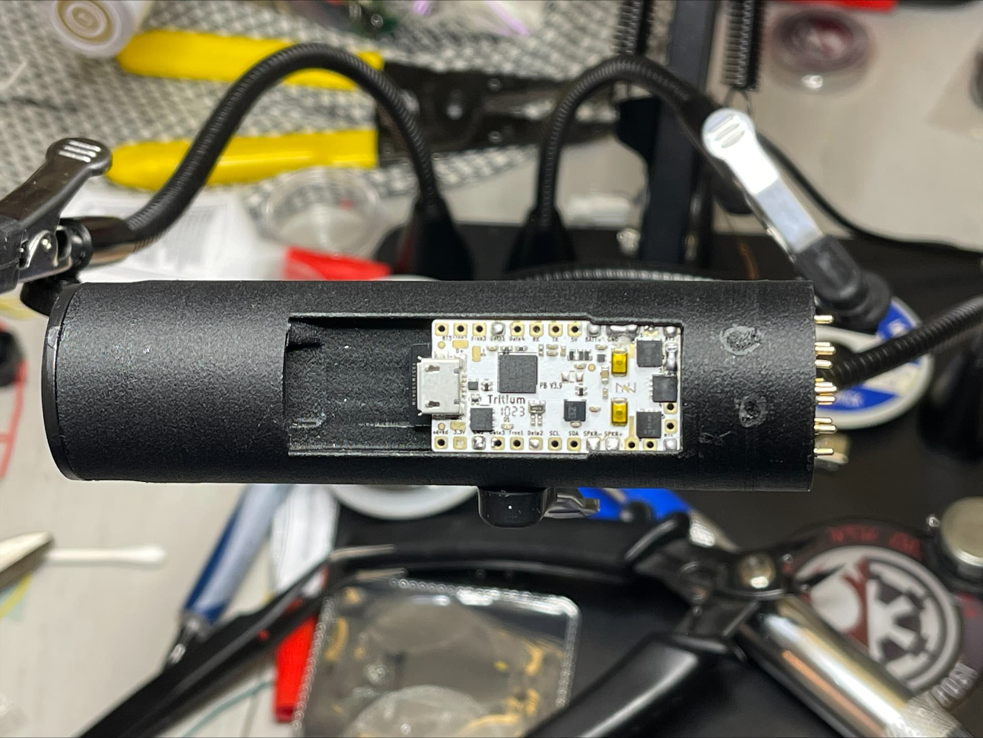

In general, if you’re reading 4.1v between BATT+ and BATT- on the board, at the same time as the board is reading a much lower value, then there is something wrong with the board and you should ask the seller for a replacement.
Note that “at the same time” is important, because if your wiring or your battery is bad, then you might have 4.1v between BATT+ and BATT- until you turn something on, and then it drops significantly.
Thanks for the reply! I checked the serial monitor and I have attached what I am seeing while the saber is on and the battery is in the chassis. While I was testing, I noticed that the blade would ignite until the board started beeping then it would shut off and not light back up. Also, I can twist to ignite while the battery is only powering the board and the speaker inside of the lower chassis and it would still give the low battery warning and never stay on and “humming”. I have attached the results of the serial monitor, the lower chassis, and a close-up of the board itself. If you need to see the other side of the board just let me know and I can de-solder everything and take it out.
