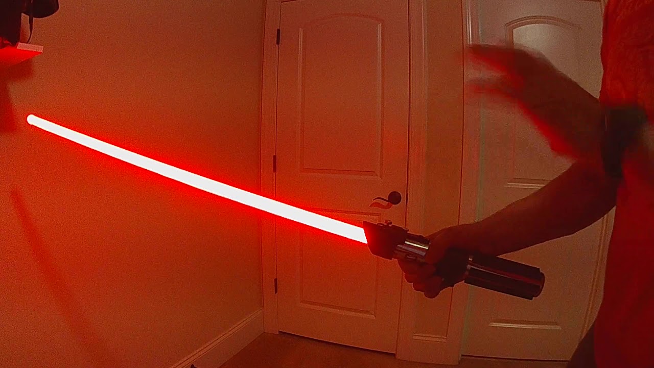

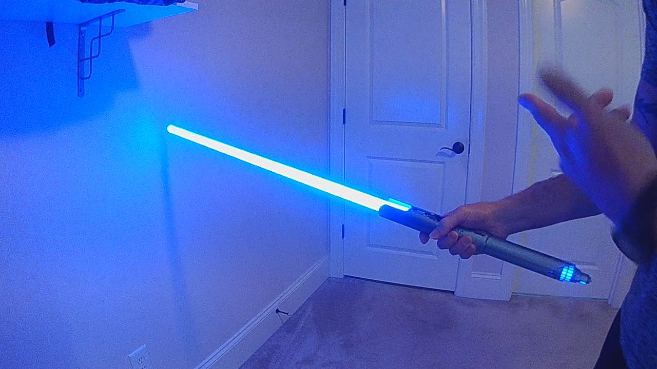

“Select Presets” is built into my prop, it’s not part of Edit Mode, instead it uses a dial menu to scroll through all presets as an option beginning in OS6 (it’s available on 1 button or 2 buttons with different controls for each).
Here’s the original POC video to show. The difference in the final version is it now uses the Voice Prompt mpreset.wav instead of font.wav when first entering.
It’s demoed here at the 2:25 mark as well for 2 button controls:
For OS7 I’ve expanded on the feature and enabled “Quick Select” which will let you rotate to a preset and then immediately select and ignite with one button press instead of first selecting and then igniting as 2 steps.
