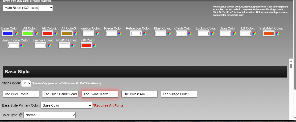

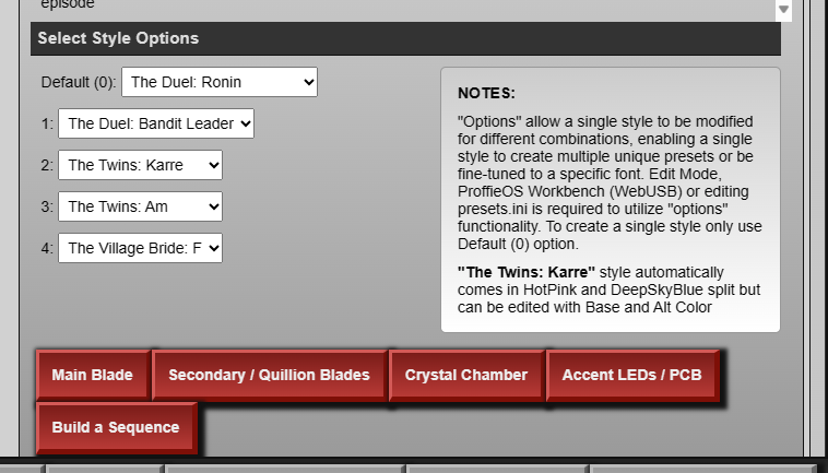

I am probably not understanding the library then. On this page you can select different options and when I do it this way, it looks like I get the different styles?
and then on the main blade config button I see the other options? but do I set the color there? How do I set the multicolor for Karre?
See the NOTES :wink:
If you select “Option” styles you then have to change your Style Option to the appropriate number via Edit Mode or ProffieOS Workbench or using the arguments in the config tool, otherwise only default is used. Watch the videos at the top of the Config Tool, to see how to set Arguments
If you’re not using or wanting to use options just change Default to the style you want and generate them individually.
