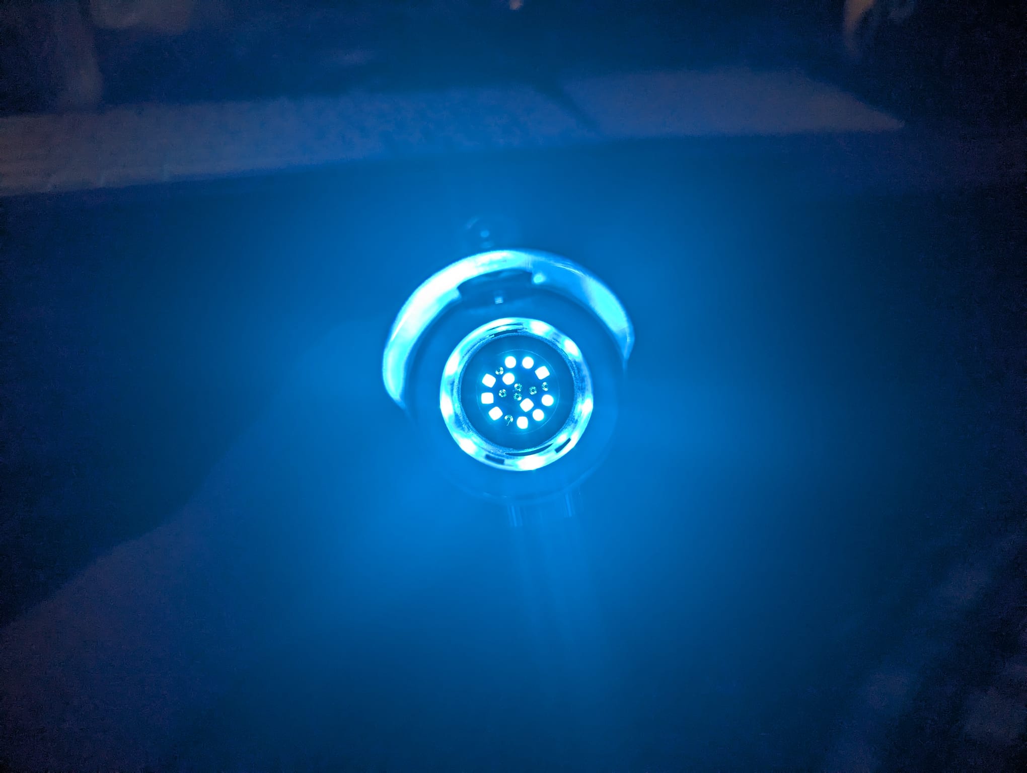

Just flashed the unit and everything works great - except the proffie itself no longer lights up :rofl:
(I’m talking about the light that shines from under the pin connectors in the selected colour, not the green indicator light). I assume most proffies have this?
Not important. I only need lights on the hilt/blade, but I’m dumbfounded why that would suddenly be broken. If anyone can give an explanation/fix, I’d love to learn what’s changed.
Do you have the original/unmodified config. I guess you do have 3 blades after all. A blade under ProffieOS is anything that lights up (or spins - like a motor). So since your config doesn’t declare the hilt side connector as a blade, it won’t light up either (the hilt side is usually 2 blades on its own - inner & outer ring).

Also, not sure if this throws a spanner in your theory, but the emitter lights on the hilt work fine. It’s purely the lights that shine out of the top of the proffie itself that have stopped working.
My guess those might be accent leds ? The blade config you posted above has 3 blades, all connected to a different “pin”. Proffieboard doesn’t know what is connected and only send a signal to where you say a " blade" is connected. So if you have more blades connected (2 or 3) to a different pin, you need to declare that in your config: num blade 2, 2 blades in bladeconfig & 2 blade styles in each preset. They all need to match. Same for 3 “blades”. If you miss one somewhere, you’ll get a compile error. If you “forget” a blade “equally”, something won’t light-up.
I am not an English speaker, so I’m not sure what I said is clear ? If you declare num blade = 2, you need 2 blades and 2 blade styles per presets (not 1 or 3, just exactly 2 everywhere). But if you “physicly” have 3 blades but only declared 2, then one won’t lightup.

I suspect that my saber is actually a 2 bladed one. One is on the proffie, and the other is the emitter lights and the blade sharing the same pins. Just a hunch. Also the fact 89sabers sent me a 2 bladed config supports this.
I COULD test that theory, set NUM_BLADES to 2 and give every blade style 2 entries, but it seems unnecessary just to enable a light that I won’t even see most of the time.
