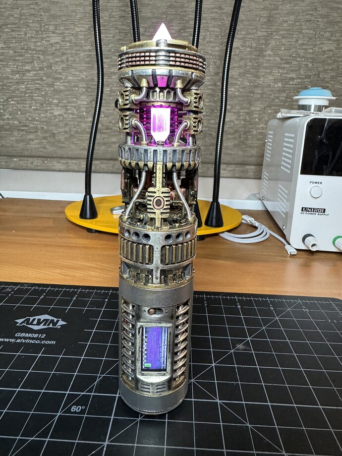

But one of my saber builds from last year has a built in color LCD.
So there’s more than one out there. :stuck_out_tongue_winking_eye:
Mine is however Proffieboard based.
Sadly, I’ve been too busy lately and haven’t been able to play with it much. :face_exhaling:
I’m loving what I’m seeing on this thread, hopefully I can get back to start tinkering with my build soon.
