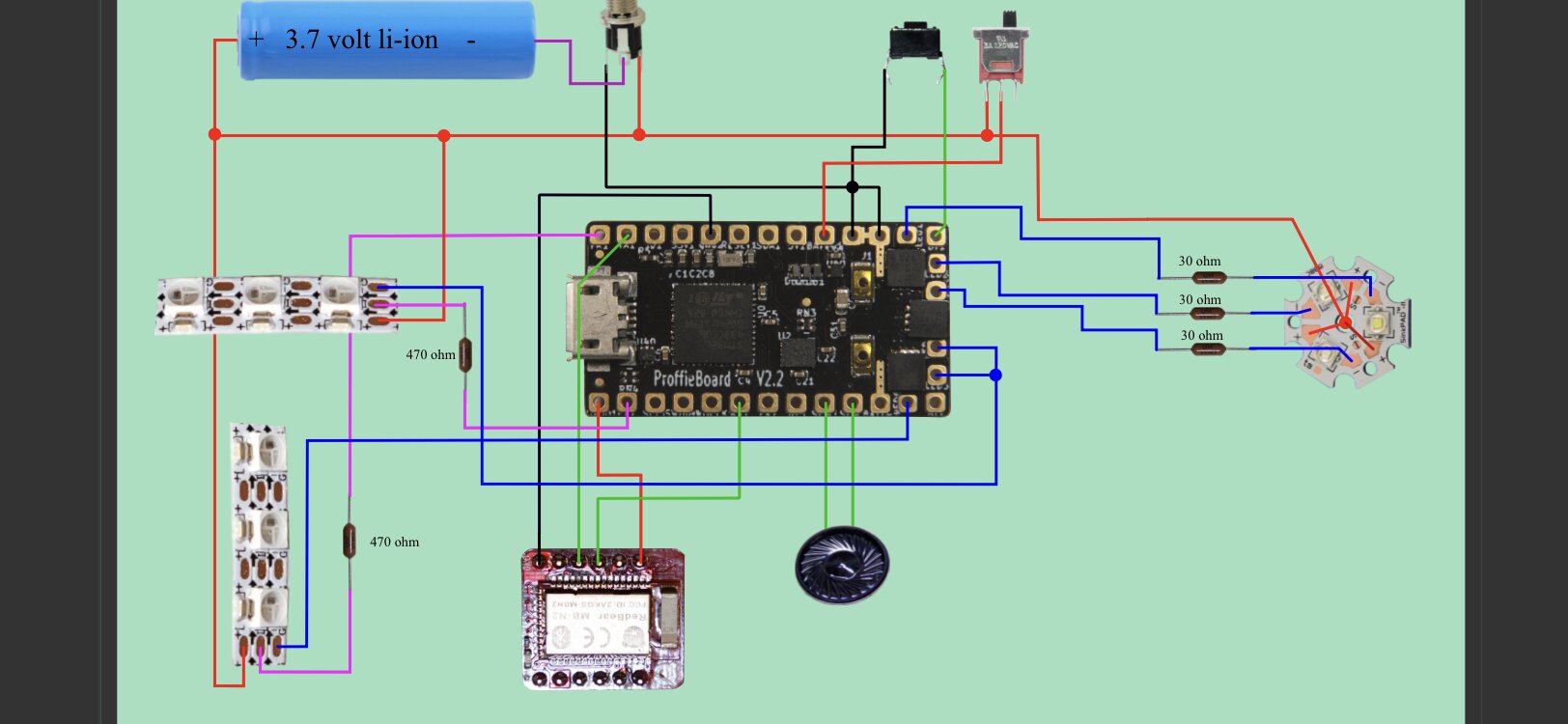

that’s good news, if the board can handle them with ease then i could possibly bump them up to the 5v versions, i will be using a v2 board for this, i will only be using workbench as a controller like u said to skip between presents and select tracks and what not.
This is what I’ve got using the wiring tool, I’ve also used a calculator to figure out the resistance values for 3v 25Ma led/laser, it wants a 30 ohm resistor when being fed 3.7v from battery.

Does this look okay or am I overcomplicating it?
I recommend replacing CreeXPE2RedTemplate<30000> with CH1LED, since you don’t actually have a Cree LED, other than that it should be fine I think.

I don’t know if having two bladePowerPin6 in your blade array is a good or bad idea? You don’t have another pad available ?
Pads are taken up by the LEDs and accent strips,
Can you put some LEDs/accent in series and use subblades ? TBH, I have no idea if it is ok or not, but in doubt I would lean towards not.
Edit: Unless you want the other leds on bladePowerPin6 to be full “on” one color all the time ?
Brainfart, bladePowerPin6 is power and not data. No clue if/how that will affect the Bluetooth or shared leds functioning?
Yes I’m not sure myself, I think it’s used as the negative line, the 3 led/lasers having a pad each is probably a bit over kill
So does anyone think it will be OK to share power pin6? Or should I make some changes? I’m stuck at what to do
