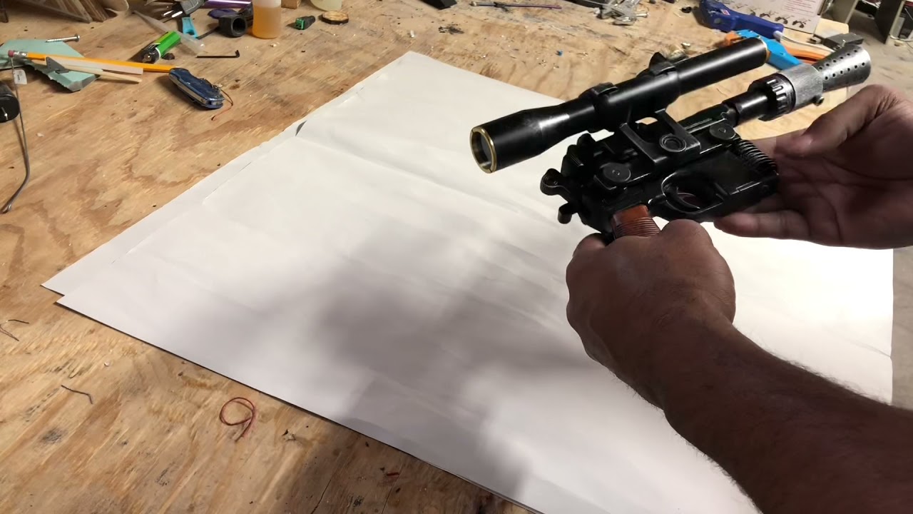

I’m doing a DL-44 build and I’m getting close to complete but I’m confused a bit on the format for the Blaster style. I’m using this:

Finishing up the build with a wall mount and serial plate.
