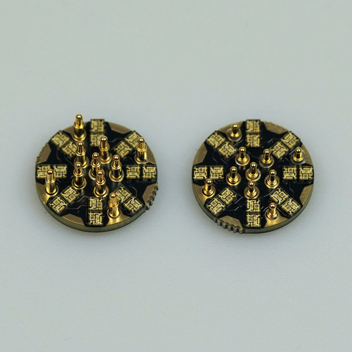

You either need a connector like this with a Blade Detect pin:

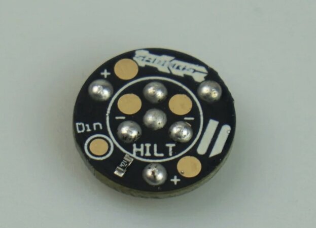

or you can achieve almost the same thing using BladeID, but you would need to add a resistor at a strategic point in the blade or fixed hilt internals depending on application:
Blade ID can often work without a resistor, but it’s a bit unpredictable, so you have to try it and see.
Use our NPXL V4 connector with a Blade Detect ![]()
