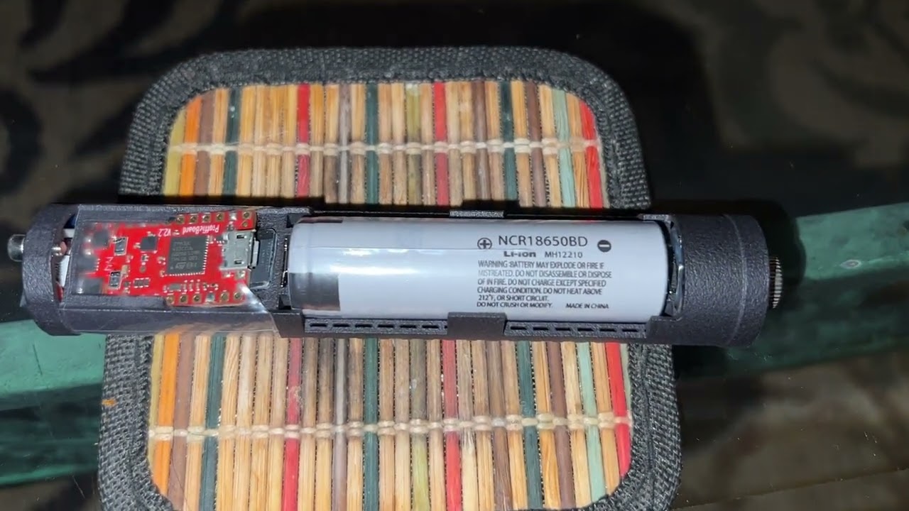

I recently bought my first Proffie saber - Ultimate Works Hero V1 from The Pach Store. After watching a million YouTube videos, I successfully flashed the board with 6.7 and uploaded some fonts. I went slow. Changed a thing or two, verified and uploaded in Arduino, tested on the saber. Then, randomly, the board stopped showing up under Port. I tried the button trick to enter bootloader mode. Nothing. The board has stopped talking / responding in any way. I thought maybe the battery was dead so I fully charged it and tried again. Nothing. Frustrated, I left it alone for a few days. Then I popped the battery back in and it started doing this (see link below). Sometimes it also says SD card not found before the clicking sound. Saber won’t turn on if I put the core in.
Please help @profezzorn. The Pach Store said they can’t help me until you diagnose the board. I think the board / battery might be bad. The board did get scorching hot when plugged into my Mac for Arduino. This is the cable I’m using. I just got it for this board. It worked for several transfers.

When I touch the plastic covering the board the whole area is blazing hot.
The board got so hot it looks like the SD card is warped and I can’t get it out. They need to replace this.
I would agree. A hot board is caused by a short somewhere. Either inside a chip, or outside of a chip. Either way it’s not something you should have to deal with if you didn’t wire up the board yourself.
