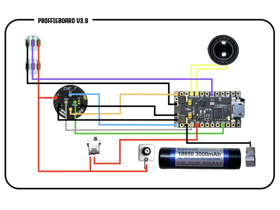

I built myself a KR sabers Regiis with the Eco CC chassis and Proffie v3.9 board.
I followed the wire diagrams from The Saber Armory and wired the Crystal chamber LEDS separately onto the Board.

It might be easier for us to help you if you would post a copy of the wiring diagram that you followed. I am definitely not familiar with every saber from every sellers and all the possible wiring diagrams.
Which pads did you use ?

Soldered the data wires to Data2 on the proffie board.
You might probably want to create your first generic config here:
Then you can post your config here using the 3 back ticks method, like this:
your config here
then we can see if your config matches your wiring
