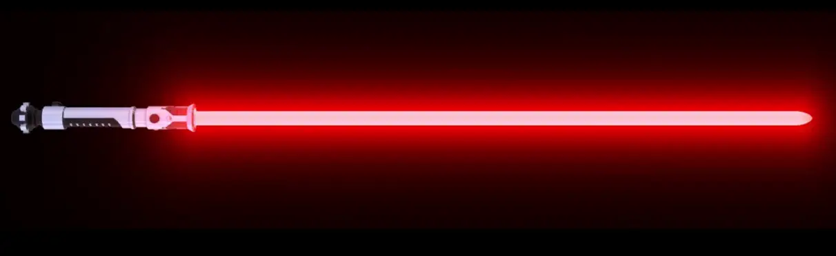

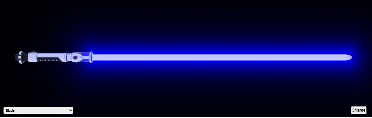

Oh! Yeah, I see what you mean. So maybe more like one of these, where “black” just means whatever is under the first style gets revealed, another color or black?
redtoblue
redtoblack
Layers<
  Black,
  AlphaL<Red,IsLessThan<RandomPerLEDF,ClampF<Sin<Int<10>,Int<-8192>,Int<40960>>,0,32768>>>>
Yes! Exactly this.
