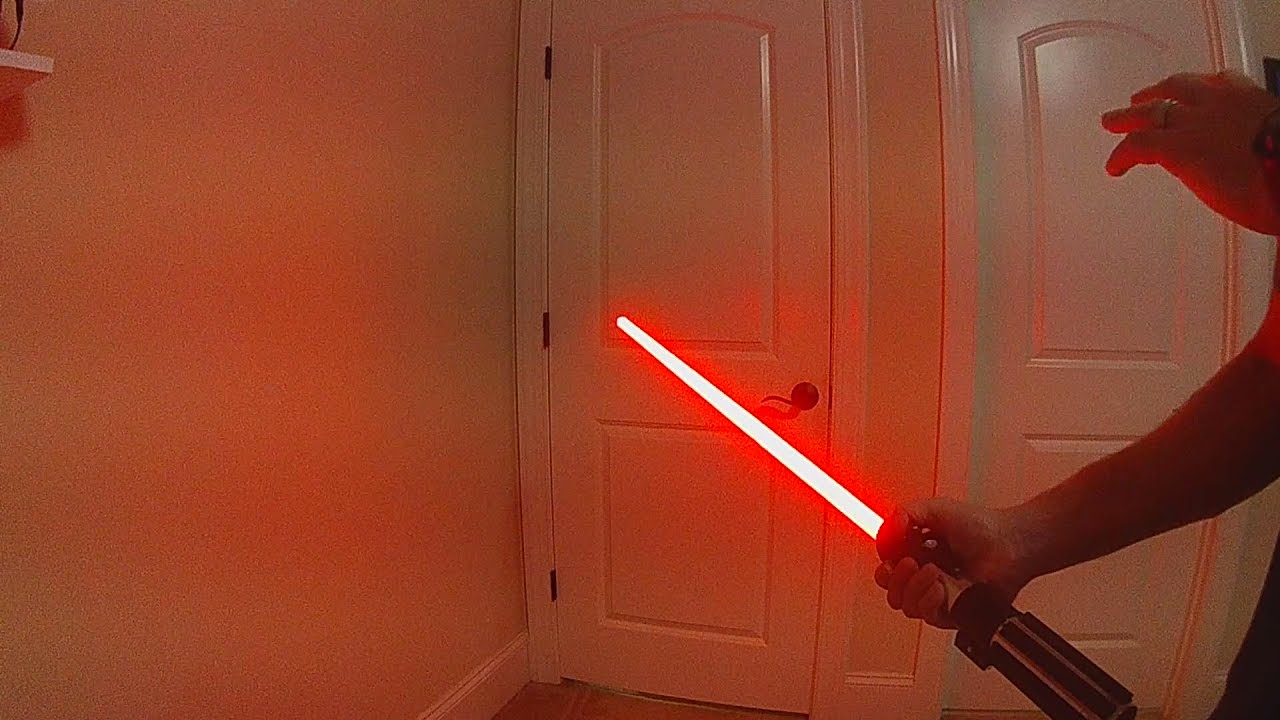

To get a feel for how this works, you can just change the swng accent sounds to something obvious that stands out clearly different than your swingl/swingh sounds.
Swing the saber around slowly, then do a quick swing movement to hear the accent sounds.
Since OS6 we also have Acceleration Based Accent swings
Info here:

I watched the video carefully, and understood the meaning of the accent swing .
Thank you very much !
