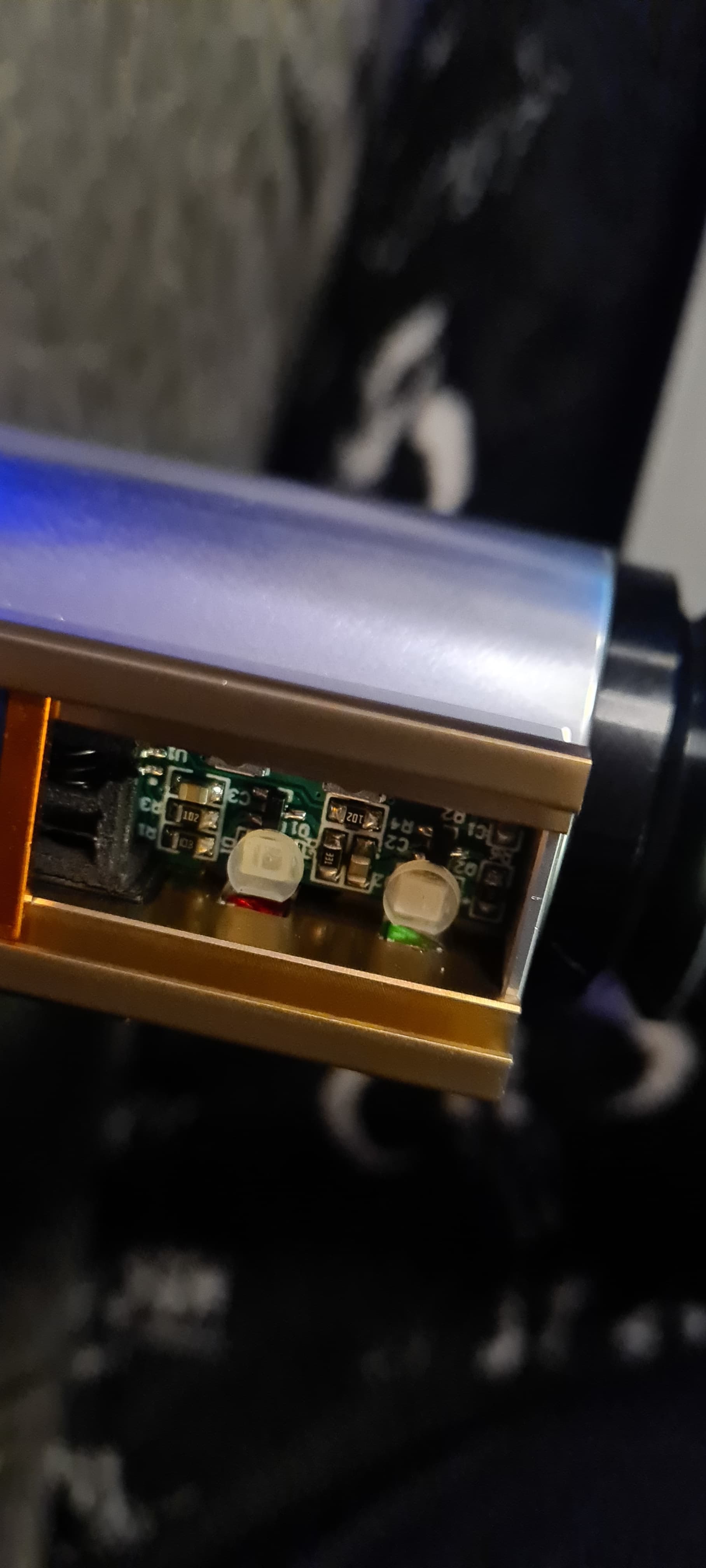

they are just two plain single led lights in the control box.
And what LED channels are they wired to?
That i have no idea, my knowledge on these things isnt that good.
This is inside control box
All i know is its an 89 sabers Luke V1 proffie 3.9

 { 0, WS281XBladePtr<128, bladePin, Color8::GRB, PowerPINS<bladePowerPin2, bladePowerPin3> >(),
    WS281XBladePtr<30, blade2Pin, Color8::GRB, PowerPINS<bladePowerPin4, bladePowerPin5> >()
  , CONFIGARRAY(presets) },
this was the original config file on the saber
just to confirm i have put this config back on the saber and the lights work on the control board so now its just what from this config needs to go on my config for it to work

 { 0, WS281XBladePtr<136, bladePin, Color8::GRB, PowerPINS<bladePowerPin2, bladePowerPin3> >(), CONFIGARRAY(presets) },
im wanting it to work with this config its just a basic config nothing fancy
