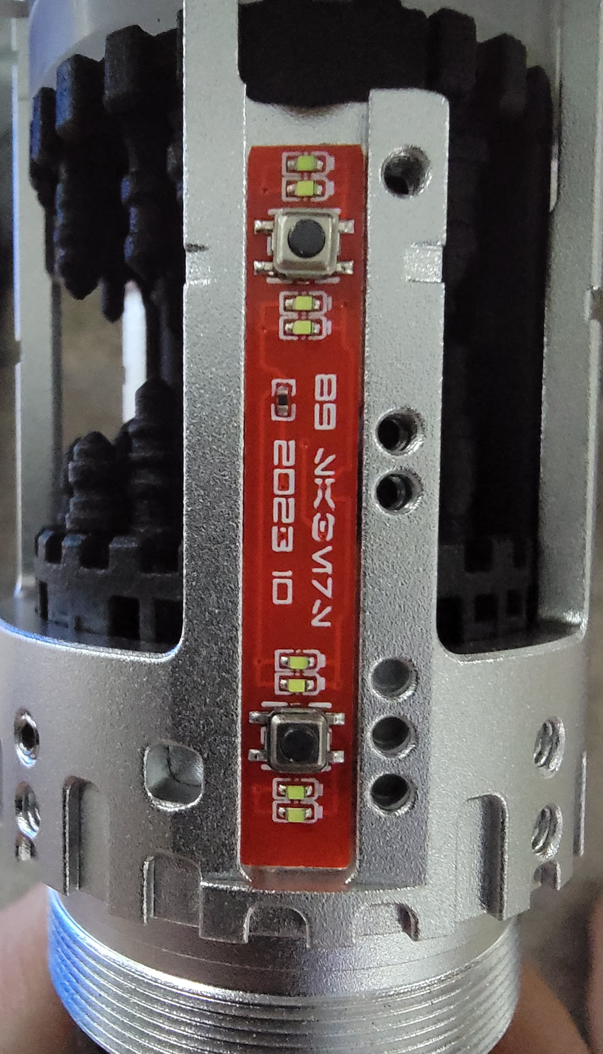

Trying to get the button lights to change (or be assignable) on each preset.
Currently they only seem to light up white.

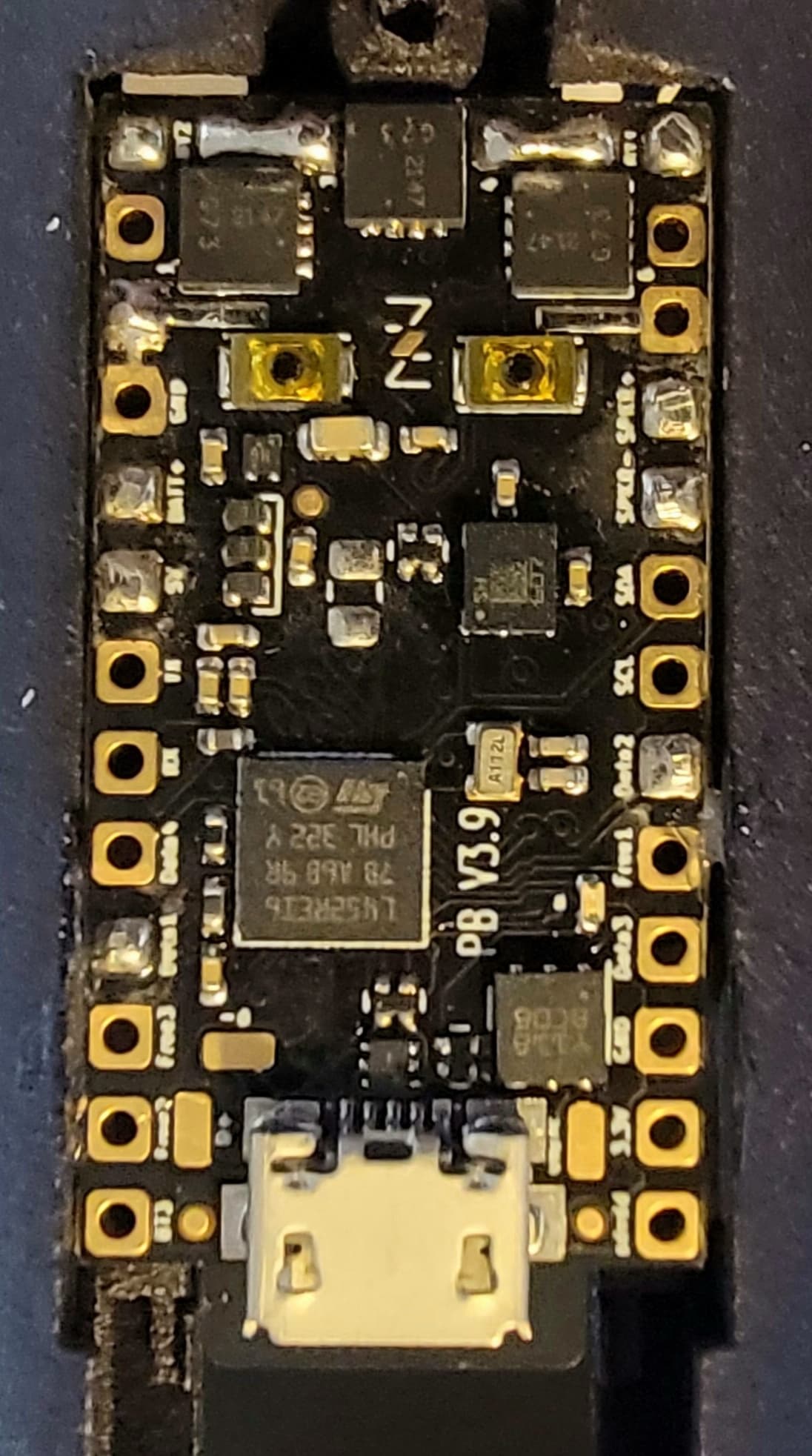

Pics of the switches and the proffie if they help:
Those SMD LEDs by the switches look like single color. They might only do white.
Videos on 89sabers’ Facebook show that the buttons do change color. Just once again I don’t know how to do the coding for this area.
That’s not possible with these LEDs.
These LEDs are definitely single-color.
Thanks for confirming.
My 89sabers kylo came with the same pcb and I was dead set on getting the leds individually addressable. After some modding I was able to get it to work but then Shadowfoil props came out with these which are the perfect size to fit in the trey where this pcb goes.
I hope that helps
Thanks for the information. Issue is I have no skill/tools to make the change from the installed switchboard to new switch board. Then I have questions about how to install, and where/how to wire…
How to code for their color assignment…
Seems like more questions…
For now I have a slip of colored paper in under the buttons to switch the color.
