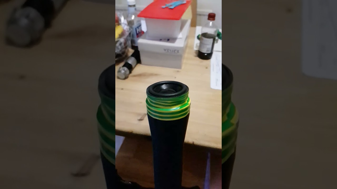

a while back i was playing with other stuff and found an iginton sound that had sub frequencies of down to 20Hz in it.
i took a slow motion video of it playing on the 40mm speaker at 2500 volume.
i must add in that at the time i did not know it went down to this frequency and was just getting some footage of the driver cone excursion.
