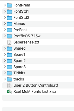

In case it’s useful on this thread, and based on what I’ve I’ve read here over the years, I’ve found that the following file structure works pretty well in terms of read speed and avoiding audio glitches:
  • Make sure all file and folder names that need to be accessed ‘live’ by the system, have eight characters or fewer;
  • Put the font folders in sub folders, with no more than 15 fonts per sub (allows one spare);
  • Name the font subs early in the alphabet - that way when you drag and drop contents onto the SD card, the fonts get loaded up first onto the fastest parts of the SD;
  • I also put expensive ‘premium’ fonts first, so they get the best possible chance of best performance;
This also helps keep the SD quite tidy, and since I try and build in as much flexibility for users to make changes by just shuffling files around on the SD without needing to reprogramme, that’s actually quite useful.
I only mention all this as experience has shown that it works pretty well. But naturally I’m always open to suggestions that might make things even better. :slight_smile:
Screenshot 2025-06-26 at 10.09.21
