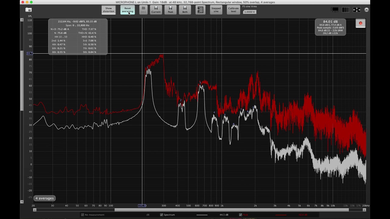

Well, this is SOMEthing. And I am actually a bit dumbfounded.
These speakers (VECO and KR so far) …are reaching down to 40HZ.
Now, that’s on mic, and I doubt there’s enough energy there to actually hear the direct frequency much with the ear, but upper harmonics are audible for sure and they hint at the bass being there. It does not sound bad! NO distortion or ANYTHING I was expecting. I’m shocked.
So here’s a few results (in screenshot form…sorry. There’s no real other way to show this.)
Adding in
#define FILTER_ORDER 8
So the filter works great. However, pure tone tests somewhat show it’s not “needed”. But actual font sounds should be tested, as there’ll be a lot of bass energy that will make the speaker much unhappier than a rolling off sine wave.
