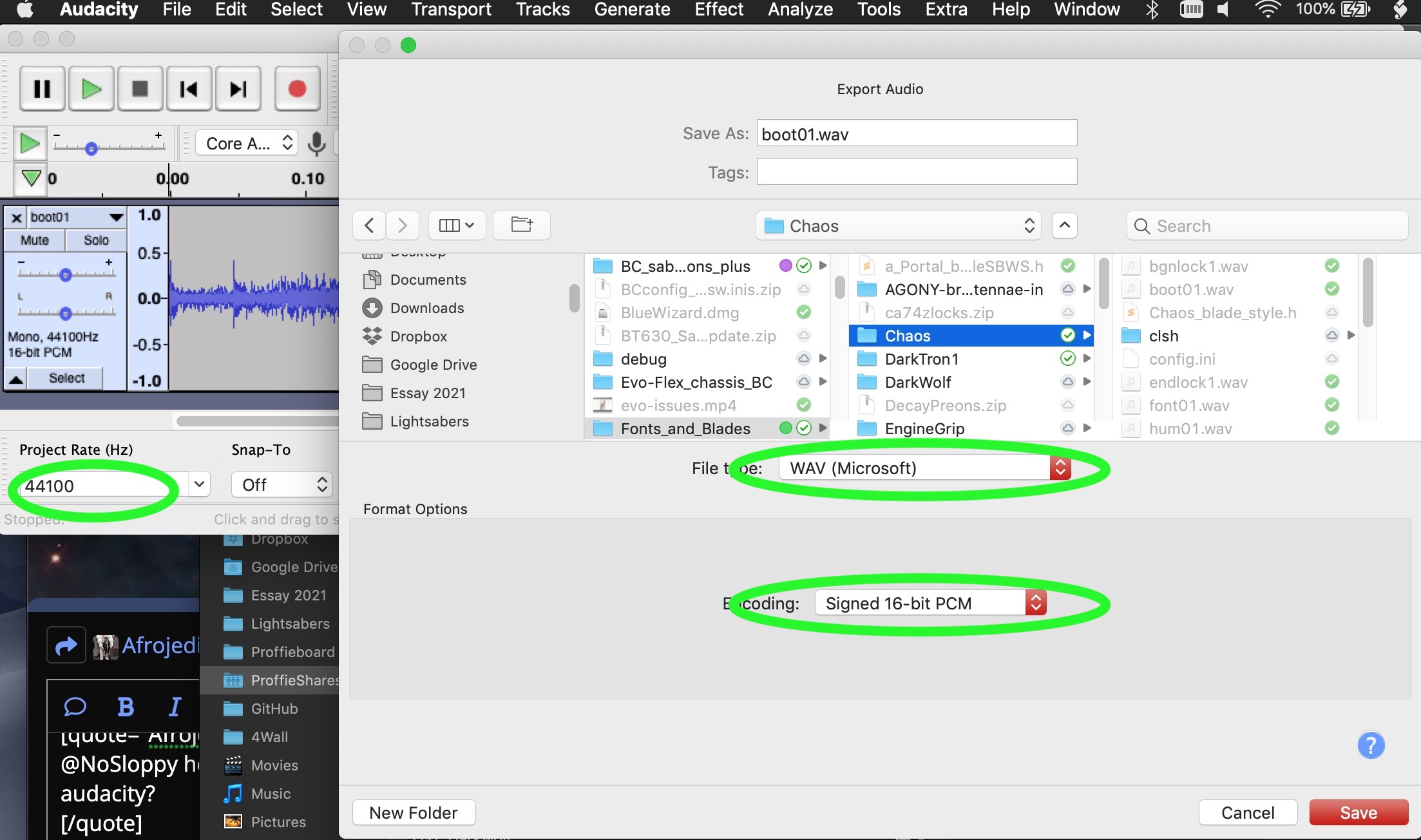

@NoSloppy how do I check if the wav files are formatted correctly on audacity?
I’d just re-export it to be safe. The Project rate in the bottom left corner set to 41000Hz, and then in the export dialog window, have the File Type as WAV, and Encoding as Signed 16-bit PCM.

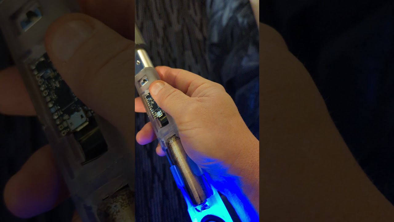

Works as expected, cool! Video for demo:
All wavs recorded at identical volumes and normalized to 0db, then copied to SD card.
(note* out.wav was recorded as “200%”, but ended up bumping it up to 250 afterwards)
