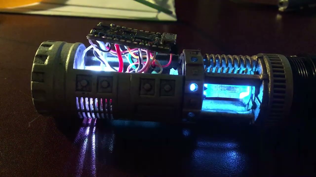

Sorry guys - possible 7.x OLED gremlin found…
Setup is three internal pixel accents wired in series and coded as sub blades to blink/pulse blue when main blade is off. In the video below, the accents in question are the ones inside the vents at the back of the speaker (two pixels) and the crystal chamber (one pixel). You can also see the OLED on the underside of the chassis reflecting off the tabletop.
The symptoms are that when the OLED battery level display switches off after about 30 seconds, the sub blade accents inexplicably light up full on - two white and one blue.
The problem doesn’t occur under USB power, only battery power.
Once the fault has started, if I power up the blade they return to normal, but again the problem returns around 30 seconds after I power the main blade down again, roughly coinciding with OLED battery level display turning off.
Config is set so all accents shutdown after half an hour.
The sub blade array is fed from data 1 so no need for a resistor.
The fixes I’ve found are:
  • Using OS 7.1 or 7.2, if I write the OLED out of the config, the problem goes away.
  • If I leave the OLED in the config but revert to OS 6.8 the problem goes away.
So on the face of it, it looks like something about the OLED setup is upsetting data 1 under OS-7.x. Of course I’m happy to be corrected if it turns out to be a gremlin of my own making, but the fixes I’ve found above make me think that it isn’t.
