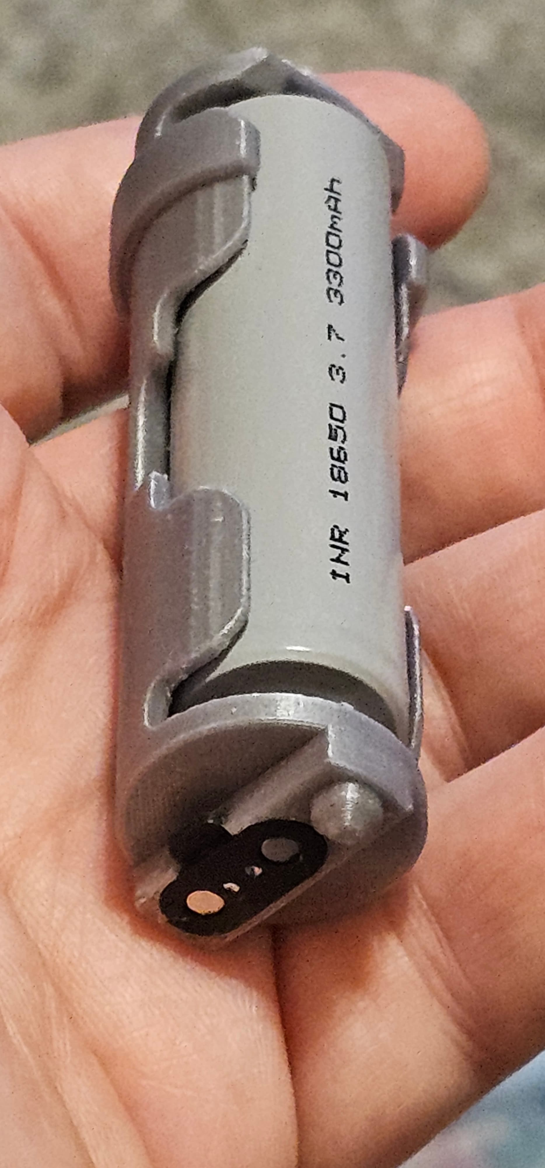

Battery comes out easy:
How can I add an image size on the photos> Yikes. I can only do one per post. Here’s the other relevant two:
You can see the test wire. I have a ground there too I’m not currently using.
