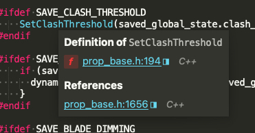

It is. just a rollover pops up a window.
Screenshot 2024-12-04 at 10.28.21 PM
would kate work? I think it does the something.

That’s what that “pop-up” is. I need to go over it slower. So far it was a nuisance that was “getting in my way”. Cool to know. Thank you NoSloppy.
Thank you Ryan
