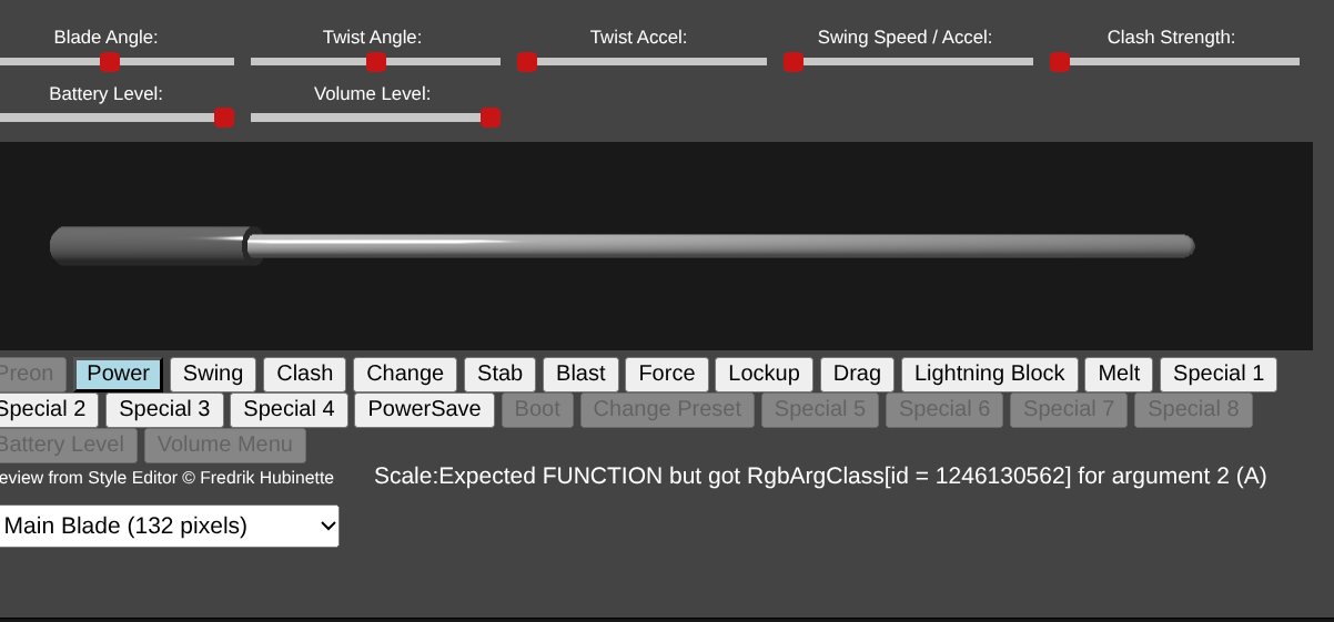

but it does keep saying this when i change effects
That is likely a bug in the script. Just use the “Questions or Issues” link at top of library to report it, let me know the exact options you selected that generated the error message and I’ll try to have a look this weekend.
aight man.
