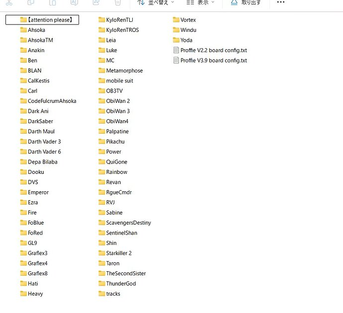

It appears that font folders containing .exe files are circulating on the market
A few months ago, this became a minor topic of discussion in Japan: it seems there are Chinese-made lightsabers on the market that come preloaded with a large number of fonts, as well as SD cards included with Proffie units that contain EXE files among their fonts.
Normally, there shouldn’t be any EXE files in a font folder, so it might be wise to exercise caution.
I rarely purchase ready-made Chinese products or SD cards myself, so I don’t actually own any of these items, but I’d like to hear the opinions of those in the know.

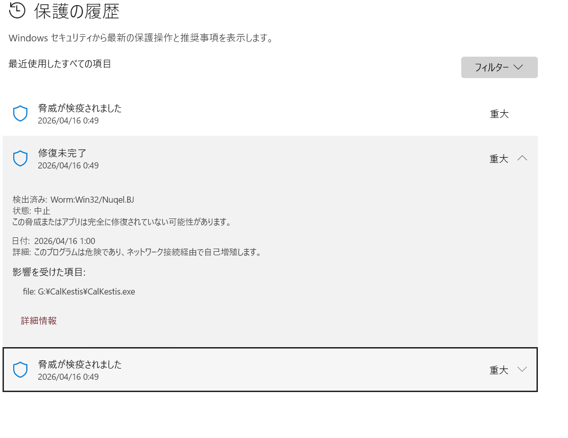

I had come across this once with a SD card that came bundled with a Proffieboard from AliExpress, and Windows Defender managed to catch them instantly, so I have to imagine they’re almost certainly malicious. If you still have access to those .exe files, I’d be curious as to what virustotal has to say about them (I, like an idiot, just nuked the sd card immediately instead of investigating)
Same here. I purchased a single proffie with SD card from AK Sabers on AliExpress cause I wanted the fonts for my curated collection of crappy default/included fonts. Windows Defender also immediately caught mine and I think I remember the ID was MIME disguised trojan, and very old. I quarantined it, got the fonts and then nuked it all.

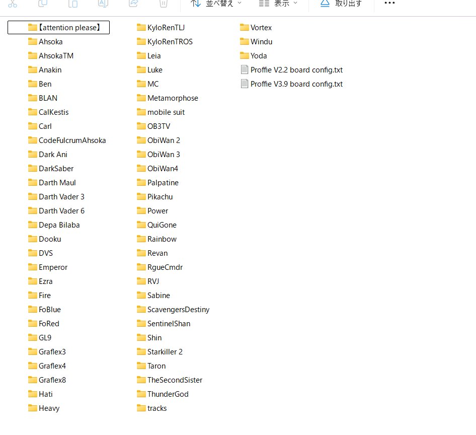

So this means just any .exe file in an individual sound font folder might have them, or is it under some weird named folder like [attention please]?
There were several copies in the one I got. One in the root and some in the fonts. I just scanned the whole drive and they all quarantined.

I had the exact same issue with an AliExpress Proffieboard order (from “Lightsaber store Official”) back in March. The .EXE file appeared to be an old worm that replicates itself to flash drives. So my guess is that it’s either an infected computer at the main distributor of these Proffie font files, or a malicious intent. Or both.
