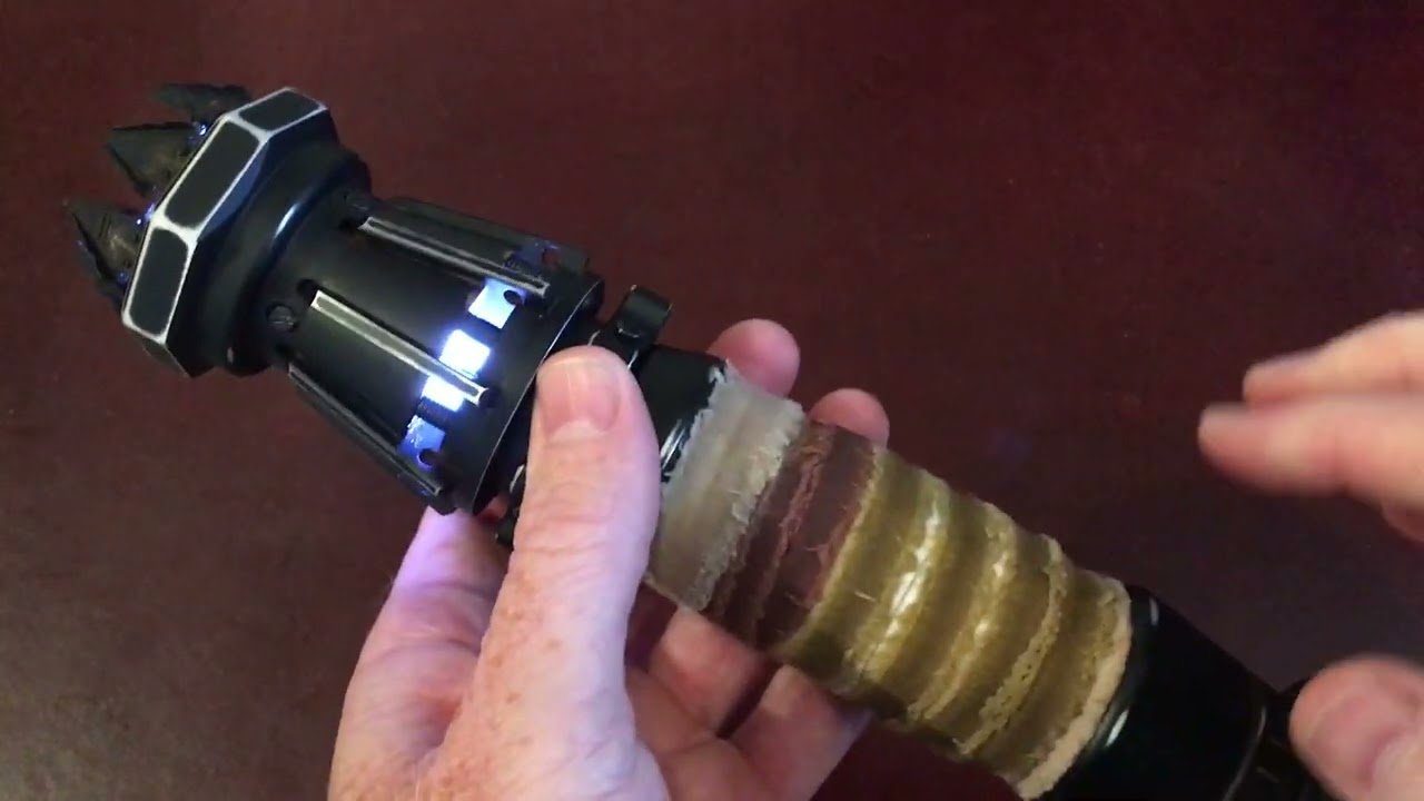

You guys are legends!!!
Prof, I didn’t need to go as far as your last suggestion as Brian’s 3rd Prop file did the trick. (y)
What’s more it works, and makes it much easier to ‘navigate’ the button without using too much force not knowing if you’ve engaged it or not.
Guys, thank you, thank you, thank you! I can’t thank you all enough!
And in case the end user doesn’t like it, I’ll include two shorts files of silence on the SD card so that all they need do is rename those files to lose the clicks.
Thank you again!
Here’s how it looks/sounds in action:
