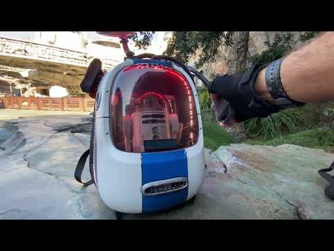

So I took it to the park yesterday and had a full day to see it in action.
Other than the volume menu, everything works without rotating the DEP.
That’s awesome. You should do a HAL9000/Discovery One font for it!
SO GOOD, great work dude.
