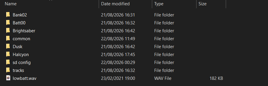

Hi all! I’ve spent about 10 hours now (continuously) trying to get this to work overall and seem to be drastically failing. One of my fonts won’t even appear? (Duskwarden). I have enclosed my config file, a screenshot of my SD card, and the voice file I’m using.

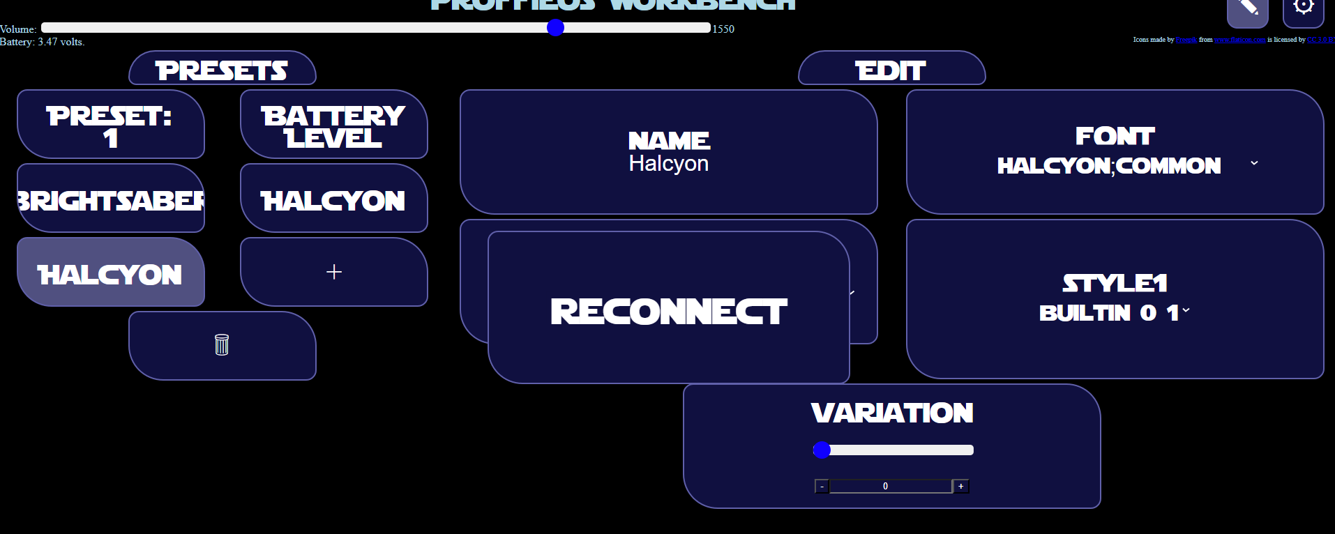

My WebOS layout:

I appreciate how thorough your responses are! I’ve got some of the fonts loaded in now, but can’t seem to get one to be recognised on WebOS. The error is below. I have concluded with the help of some lovely people on Discord that this is because the voicepack I was using is a V2 voicepack. I’m still struggling to get WebOS working, you say that it’s because the style isn’t built for customisation which makes sense - do I have to add a style to build out changing colours and things? The four fonts I have loaded are ‘Brightsaber’ ‘Duskwarden’ , ‘Halcyon’ and ‘Rey Skywalker’ with only Brightsaber, Halcyon and Rey appearing. I’m new to proffie, and have tried to take the learning curve head on - lots of trial and error!

The ProffieOS Workbench (what mistakenly is calling “WebOS”) is somewhat limited when it comes to customizations. For each preset, you can choose which font, track and style to use. However, it can only choose from the styles that are present in your config file. Your config file only has one style in it, so that is your only choice.
If your style can be customized (Styles which can be customized have RgbArg or IntArg in them) then the ProffieOS Workbench will also give you options to change those colors and integer arguments, which is probably what you want.
The easiest way to get a style that can be customized is to use Fett263s style generator.

So if you type list_fonts into the serial monitor, what does it say?
What is the “duskwarden” directory called?
Is there a hum.wav in that directory?

Lists all fonts in Serial Monitor:
Bank02
Brightsaber
Halcyon
Dusk
Duskwarden (Dusk) does indeed have a Hum file. ‘Duskwarden’ wasn’t being recognised, so I changed the file name to ‘Dusk’ incase it was a character length issue.

So if it shows up in “list_fonts”, but not in the workbench, that seems like a bug in the workbench. I’ll have to take a look…
