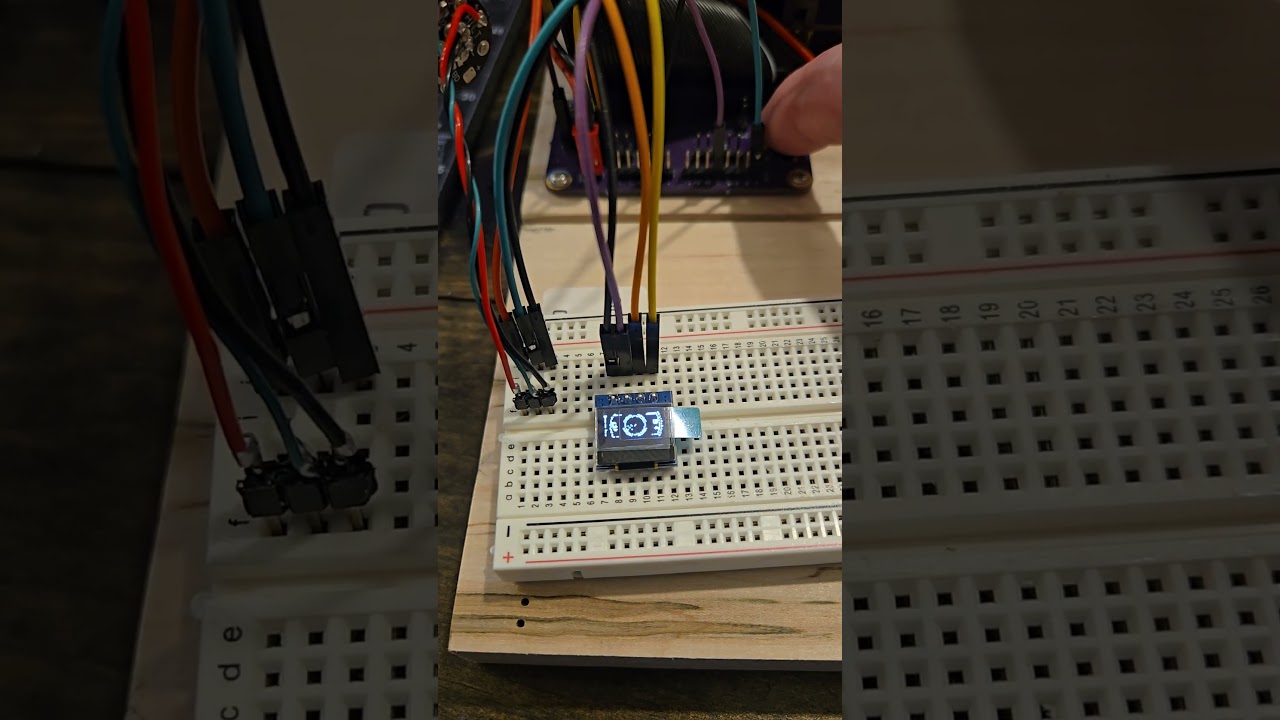

Both @orntar and I are trying to solve the “auto.bmp” conundrum.
This is the config we are using:
E11_oled.h (2.7 KB)
This is the blaster.h I came up (based on latest Github master) with the help of your code above:
blaster.h (21.4 KB)
We are both getting this error:

Works great!
PR for “auto” on OLED & color OLED submitted.
I also fixed the missing "d"s and a few other things like tabs, typo, extra spaces, extra empty lines, …
