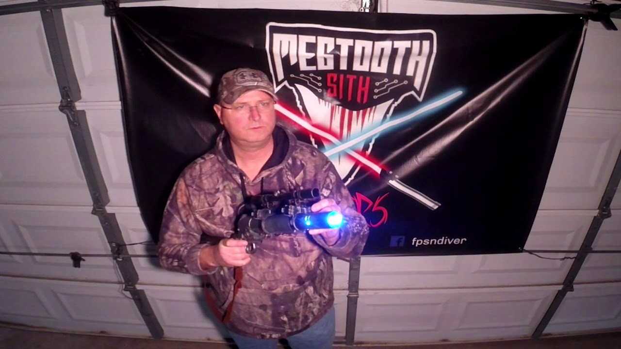

I don’t know if I’ll build my test rig this weekend, but I am going to mock up my tri cree, strips, OLED, Speaker and buttons to see how all this is currently working. It would be cool to have the bullet counts on my counter on the E11, but I still think it’d be supercool to have the Emperial Cog battery meter on there as well. I know I can make it do that. I use the pic that is already in the files for the battery meter. I’m excited for this project. I built the first Proffie Blaster in February 2020 with Dayodadjocen, who is really busy working to make those MOM Sabers with 7Chambers. But I’d love to help expand proffie’s capabilities on blaster. The one I built was really cool, and makes other Boba Fetts in the 501st Legion jealous!!!
