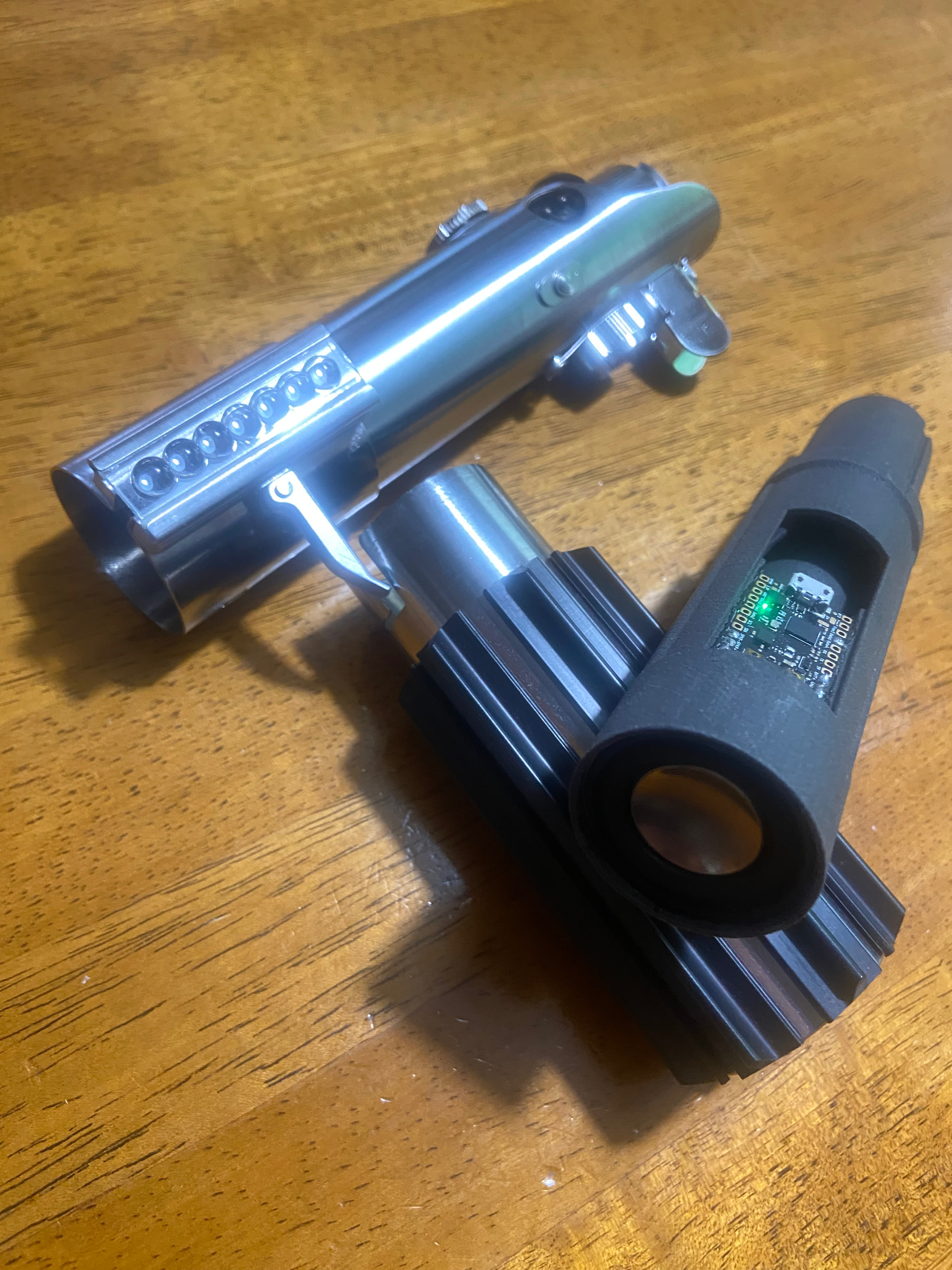

With a little ingenuity, you can improve the volume and sound quality of the Graflex this much.
Nice! A 33mm titan on the graflex sounds awesome. I have one of those speakers looking for a home so might take that on as one of my next builds. Did you have to modify the hilt to fit?
Thx!
Haha real
With vintage replicas, if you don’t significantly improve the sound venting, the reflected air vibrations will interfere with the cone and cause terrible noise.
Also, the vibrations simply travel to the slide switch, causing it to wobble constantly and produce unwanted noise.
I also tried installing the 33mm model on the KR FXkit, but since this switch is a push-type, there’s no wobbling and it works well.
