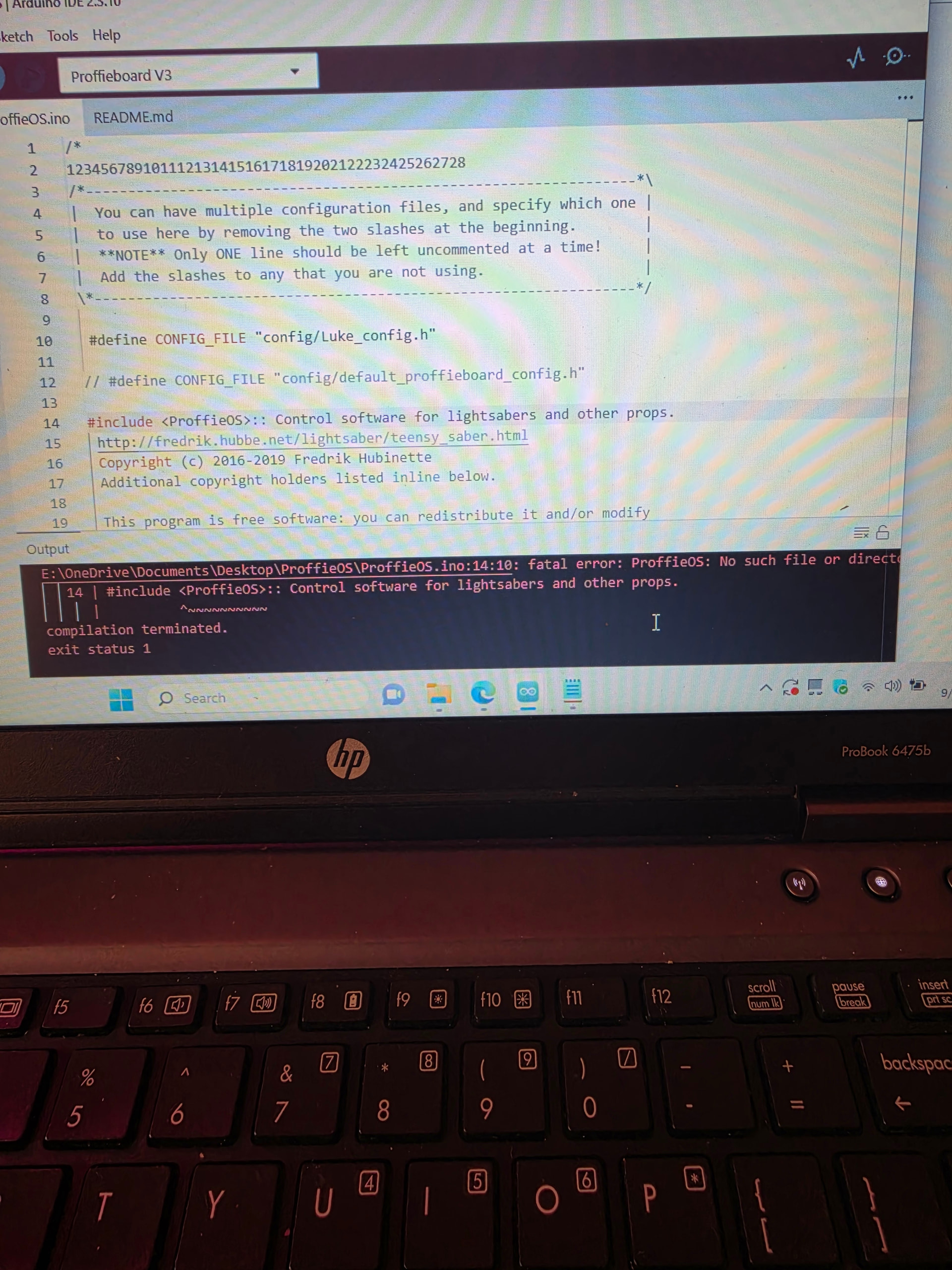

Arduino code ,anyone know how to get rid of it?
Looks like your ProffieOS.ino file got jumbled up.
I would download a fresh one from github and be sure to redefine your own config file after.
You somehow changed stuff in there.
The beginning should be this

after that, there are many more lines until #include <Arduino.h>, which looks like what you tried to replace or something?
orntar is right that the easiest fix is just download a fresh copy.

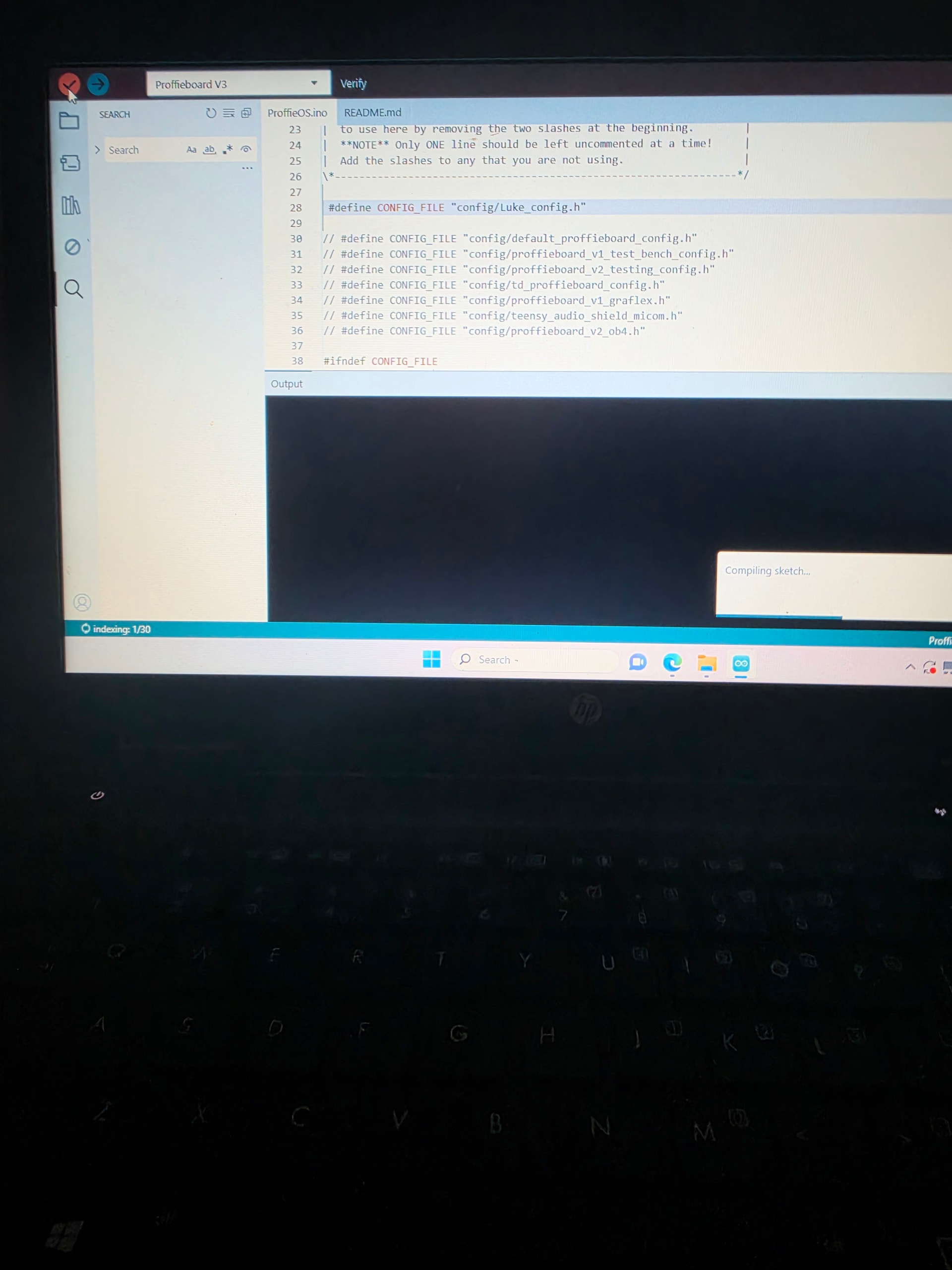

Thank you all for the help.it did work but now everything is clear the indexing is stuck at 3/30.i did add arduino to the anti-virus protection system to stop blocking program but still have the same indexing result.how can I get pass this?
What indexing, where?
Are you talking about installing the Arduino-Proffieboard plugin?
Got a screenshot if you can’t describe it?
When trying to verify corrections in arduino/library. It’s the step before you flash your proffie board.it counts from 0 to 30 indexing.
